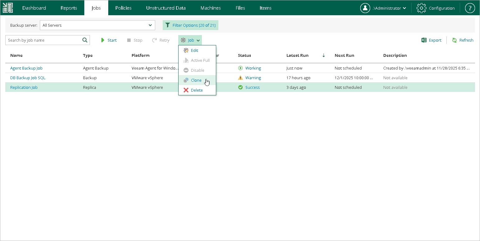

  2. Select the required job from the list, click Job at the top of the working area and click Clone.
    The cloned job has the same name as the original job plus the _cloned suffix.

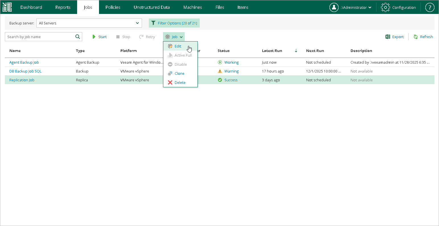

  4. At the top of the working area, click Job and select Edit.

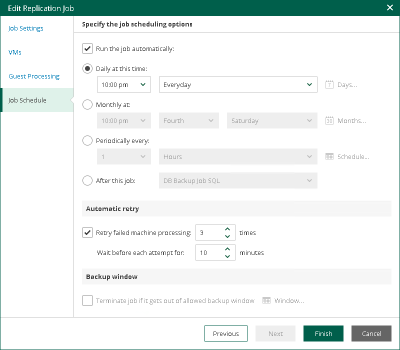

  5. Follow the steps of the wizard and edit the job settings as required.
    Change Job Settings
  6. At the last step of the wizard, click Finish.
