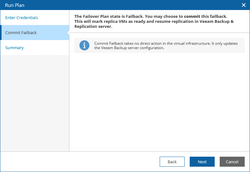

    1. Complete the Run Plan wizard:
    1. For security purposes, at the Enter Credentials step, retype the VAO Administrator or Plan Operator password.
    Committing Failback
    1. At the Commit Failback step, review the description of the commit failback process.
    Committing Failback
    1. At the Summary step, review configuration information and click Finish.
