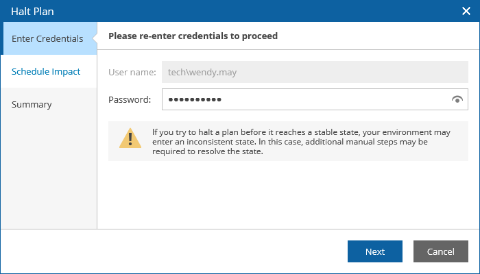

    1. Complete the Halt Plan wizard:
    1. For security purposes, at the Enter Credentials step, retype the VAO Administrator or Plan Operator password.

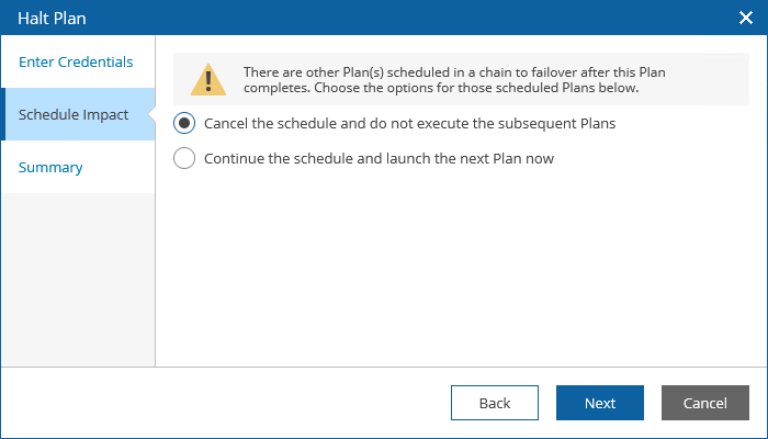

    1. [This step applies only if you have any other orchestration plans scheduled to run after the plan completes]
    At the Schedule Impact steps, choose whether you want to proceed to or cancel execution of subsequent plans after the current plan enters the HALTED state.
