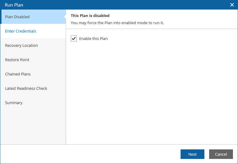

    1. [This step applies only if you have not enabled the plan before running it]
    At the Plan Disabled step, select the Enable this Plan check box to enable the plan. You will not be able to proceed with the wizard unless you select the check box.

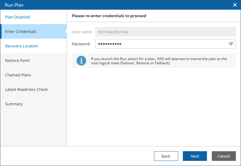

    1. For security purposes, at the Enter Credentials step, retype the VAO Administrator or Plan Operator password.

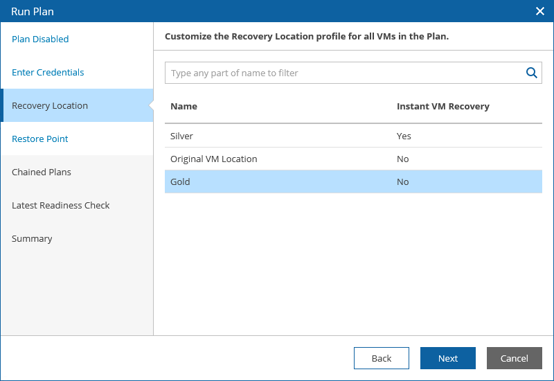

    1. At the Recovery Location step, select a location to which VM groups included in the plan will be restored.
    For a recovery location to be displayed in the list of available recovery locations, it must be created and included into the list of plan components available for the scope, as described in section Managing Recovery Locations.
    Running Restore
    If the selected recovery location includes multiple hosts, datastores and networks, VAO will use the round-robin algorithm to restore VMs added to the plan. For more information, see How VAO Processes Resources.

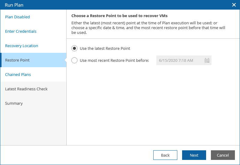

    1. At the Restore Point step, select a restore point that will be used to recover VMs.

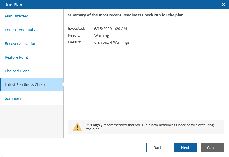

    1. At the Latest Readiness Check step, review the results of the most recent readiness check run for the plan to make sure the plan can complete successfully.
