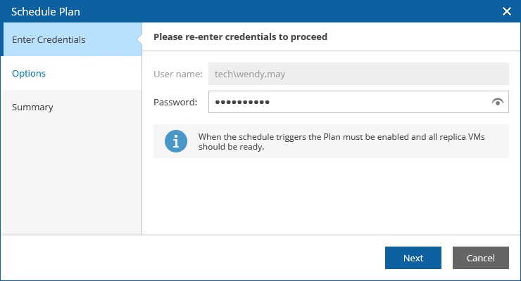

    1. For security purposes, at the Enter Credentials step, retype the VAO Administrator or Plan Operator password.
    Scheduling Restore

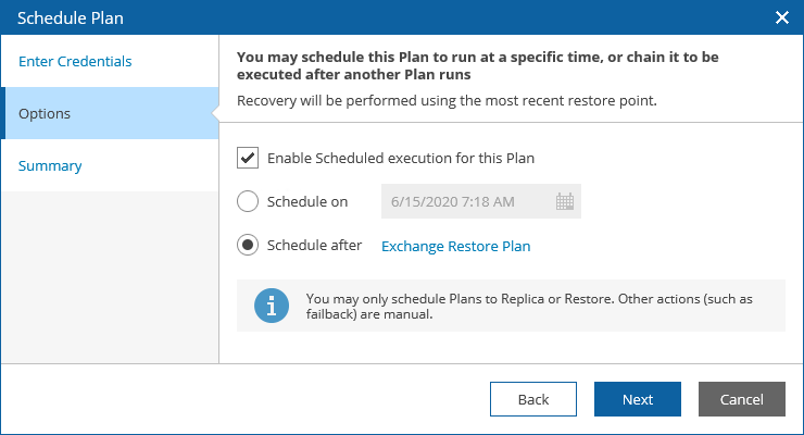

    1. At the Options step, select the Enable Scheduled execution for this Plan check box, and choose whether you want to run the plan on schedule or after any other plan.
    • If you want to run the plan at a specific time, select the Schedule on option, click the Schedule icon, set the desired date and time, and click Apply.
    • If you want to run the plan after another plan, select the Schedule after option and click Choose a Plan. Then, in the Select Plan window, select the necessary plan and click OK.
    For a plan to be displayed in the Available Plans list, it must be ENABLED as described in section Running and Scheduling Restore Plans.

    You can disable a configured schedule if you no longer need it. To do that, clear the Enable Scheduled execution for this Plan check box at the Options step of the Schedule Plan wizard.
