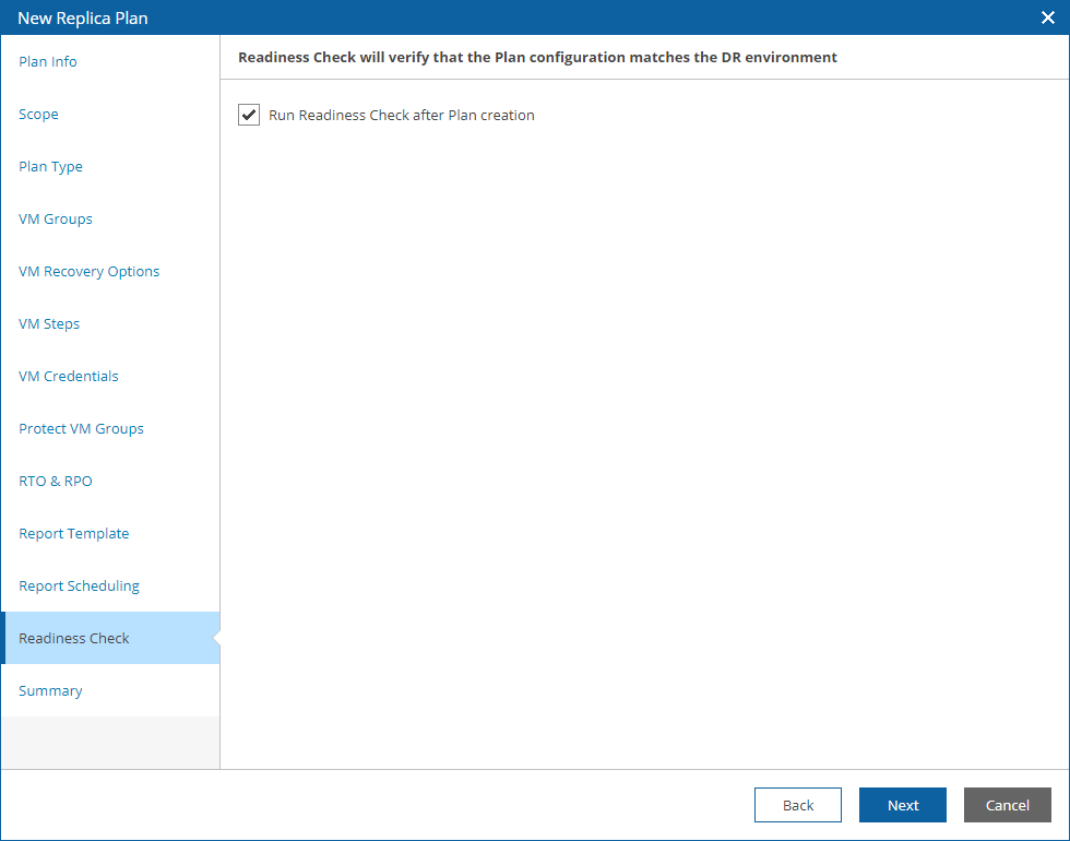

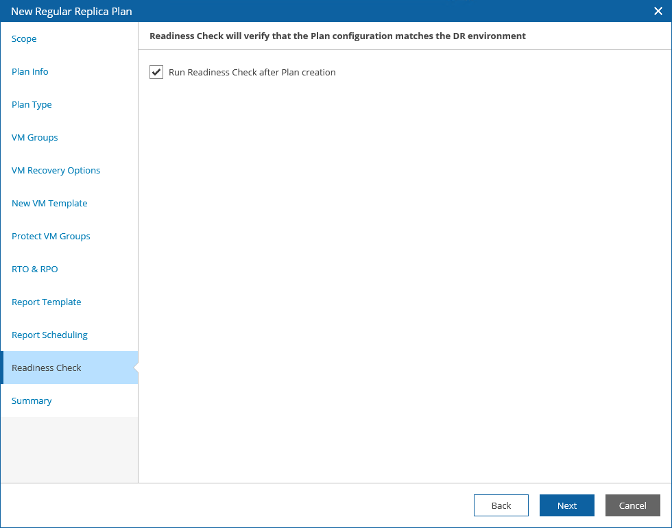

Step 11. Choose to Run Readiness Check
    At the Readiness Check step of the wizard, select the Run Readiness Check after Plan creation check box to run a readiness check to confirm that the configured settings are valid and that the plan will be able to execute successfully.
