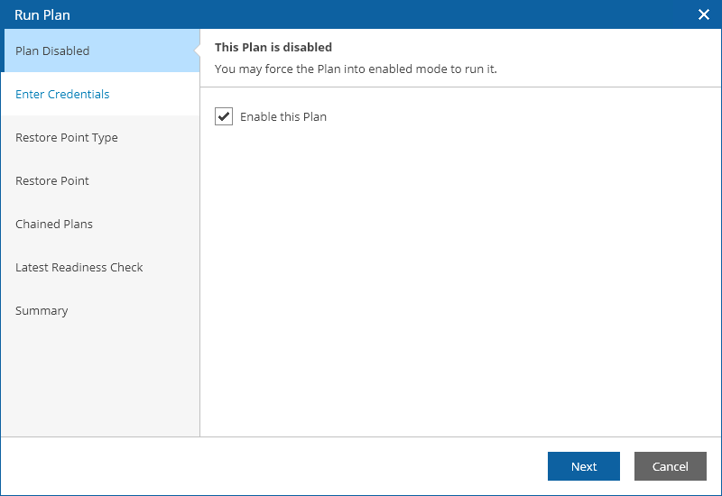

    1. [This step applies only if you have not enabled the plan before running it]
    At the Plan Disabled step, select the Enable this Plan check box to enable the plan. You will not be able to proceed with the wizard unless you select the check box.

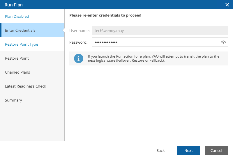

    1. For security purposes, at the Enter Credentials step, retype the VAO Administrator or Plan Operator password.

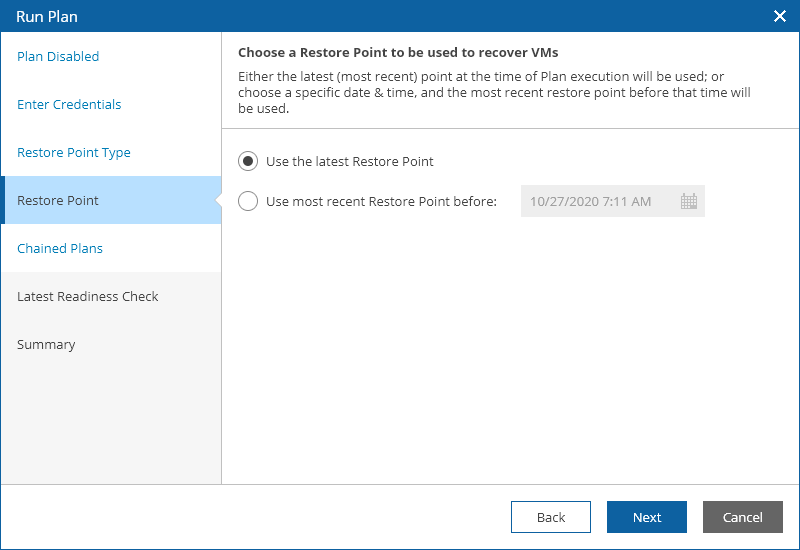

    1. At the Restore Point step, select a restore point that will be used to recover VM replicas.

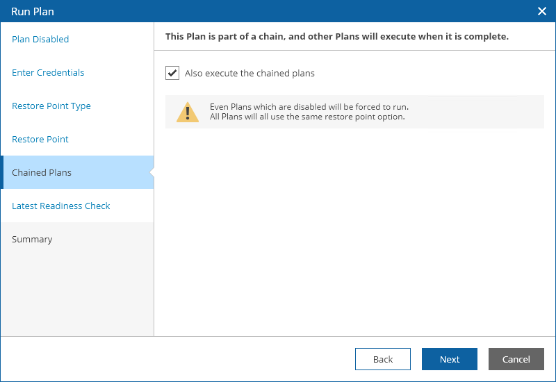

    1. [This step applies only if you have any other orchestration plans scheduled to run after the plan completes]
    At the Chained Plans step, select the Also execute the chained plans check box to proceed to execution of subsequent plans after the current plan enters the FAILOVER state.

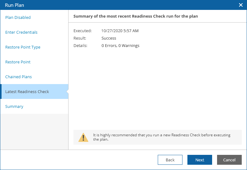

    1. At the Latest Readiness Check step, review the results of the most recent readiness check run for the plan to make sure the plan can complete successfully.
