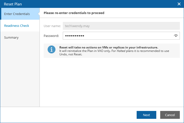

    1. Complete the Reset Plan wizard:
    1. For security purposes, at the Enter Credentials step, retype the VAO Administrator, Plan Author or Plan Operator password.

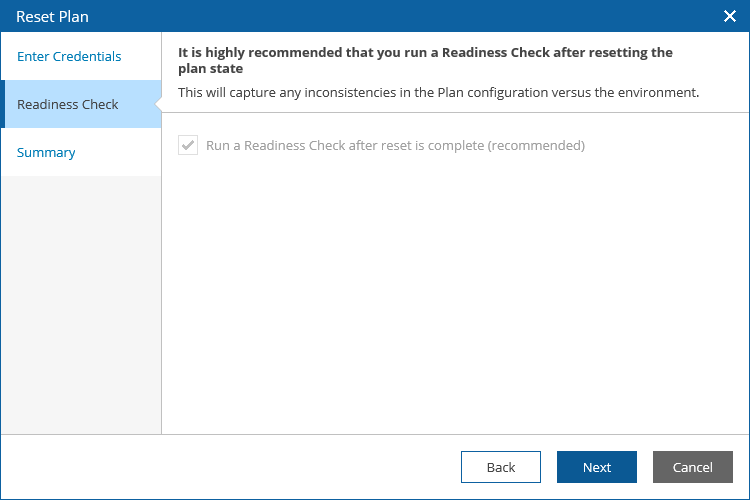

    1. At the Readiness Check step, click Next.
    Due to technical reasons, VAO will anyway run a readiness check to confirm that the changes are valid after reset is complete.
