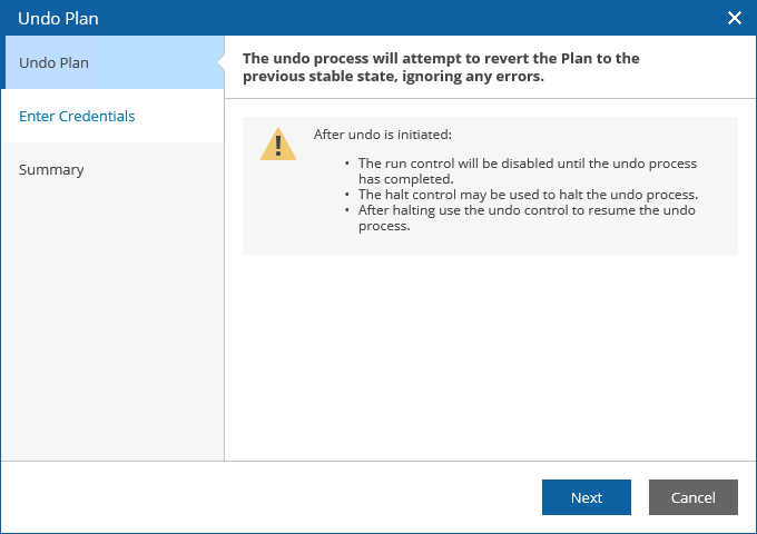

    1. Complete the Undo Plan wizard:
    1. At the Undo Plan step, review the description of the undo operation.
    Undoing Halted Plan

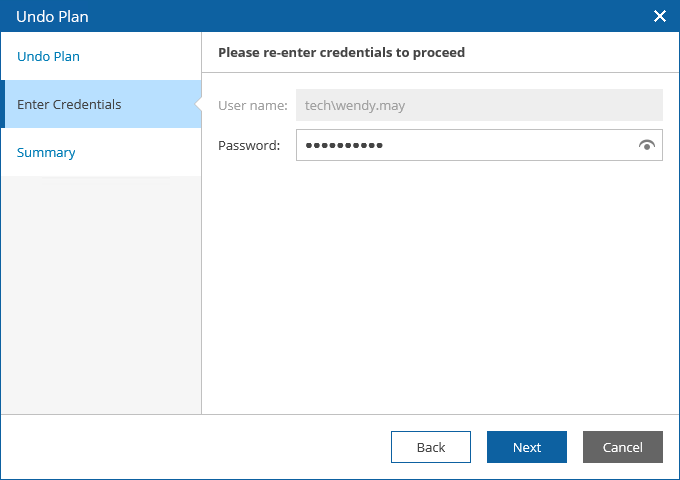

    1. For security purposes, at the Enter Credentials step, retype the VAO Administrator or Plan Operator password.
    Undoing Halted Plan
