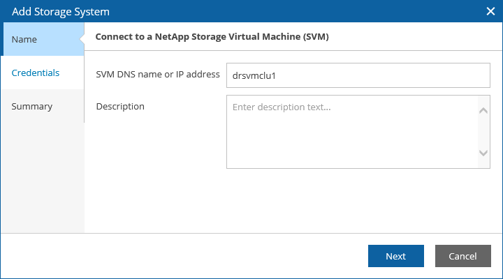

    4. Complete the Add Storage System wizard:
    1. At the Name step, use the Name and Description fields to enter a DNS name or an IP address of the storage system that will be connected to the VAO server, and to provide a description for future reference.
    The maximum length of the location name is 64 characters; the following characters are not supported: * : / \ ? " < > | .
    Connecting Storage Virtual Machine

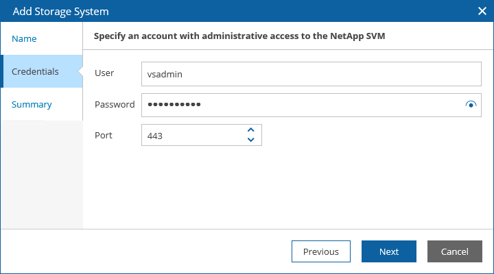

    1. At the Credentials step, in the User and Password fields, specify credentials of a user account for connecting to the storage system. For more information on the required account permissions, see Permissions.
    If required, you can change the port number used for communication with the system.
    If an untrusted security certificate is installed on the storage system, you will get a security warning. You can view the certificate and click Remember and continue — in this case, VAO will remember the certificate thumbprint and will further trust the certificate when connecting to the storage system. Otherwise, you will not be able to proceed with the wizard.
