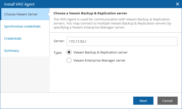

    1. At the Choose Veeam Server step, in the Server field, enter a DNS name or an IP address of the server where you want to deploy the VAO agent.
    Use the Type option to specify whether the server is a Veeam Backup & Replication server or Veeam Backup Enterprise Manager server.
    If you choose the Veeam Enterprise Manager Server option, VAO agents will be deployed to all Veeam Backup & Replication servers managed by the Veeam Backup Enterprise Manager.
    Connecting Veeam Backup & Replication Server

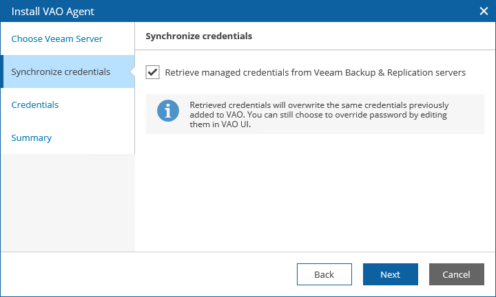

    1. At the Synchronize Credentials step, choose whether you want to retrieve credentials from the connected Veeam Backup & Replication server. You will be able to use these credentials later when configuring orchestration plan steps.

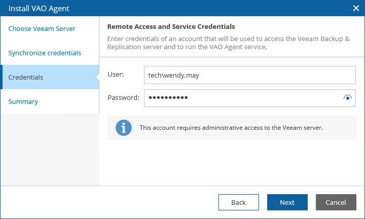

    1. At the Credentials step, in the User and Password fields, specify credentials of a user account for connecting to the server. The provided credentials will be also used to launch the VAO agent on the server.
    The user name must be specified in the DOMAIN\USERNAME format.
