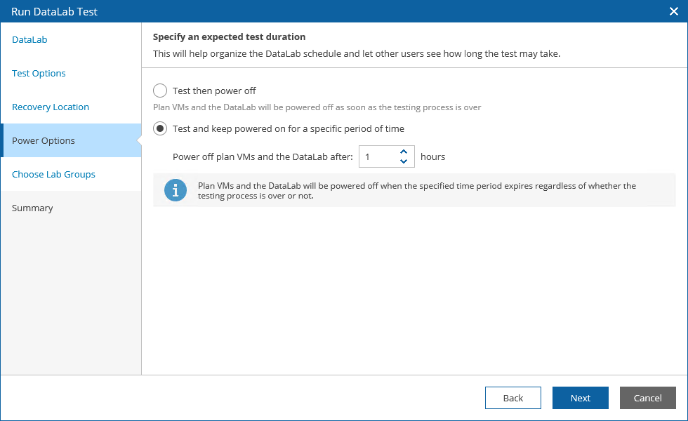

Step 4. Choose Power Options
    At the Power Options step of the wizard, choose an action to perform after the testing process is over:
    • To power off plan VMs and the lab, select the Test then power off option.
    • To keep plan VMs and the lab running in case you are willing to perform further tests, select the Test and keep powered on for a specific period of time option.
    Use the Power off plan VMs and the DataLab after field to book a time slot in the lab schedule and prevent other tests from being scheduled for the same period.
    If you have selected a starting or running lab at the DataLab step of the wizard, the lab will not be powered off after the testing process is over — even if the Test then power off option is selected. In this case, VAO will power off only plan VMs and keep the lab running.
