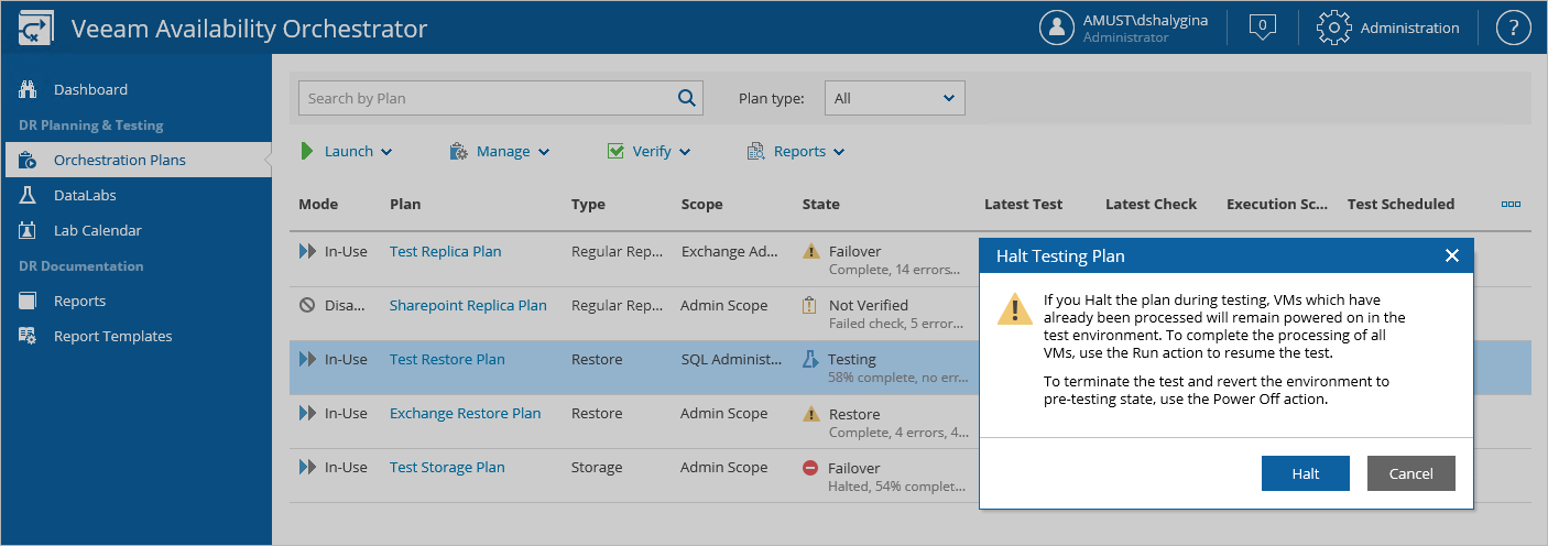

    The Halt action interrupts plan testing. You may need to halt plan testing, for example, if you need to fix some environment-related issues and then proceed with testing later (in this case, recovered VMs will still continue to run). Or you may need to stop the testing process completely, for example, if you no longer need to test the selected restore plan (in this case, recovered VMs will be deleted).
    To halt testing of a restore plan:
    1. Log in to the VAO UI as a VAO Administrator, Plan Author or Plan Operator. For more information, see Accessing VAO UI.
    2. Navigate to Orchestration Plans.
    3. Select the plan. From the Verify menu, select Halt DataLab Test.
    -OR-
    Right-click the plan name and select Verify > Halt DataLab Test.
    1. In the Halt Testing Plan window, click Halt to confirm the action.

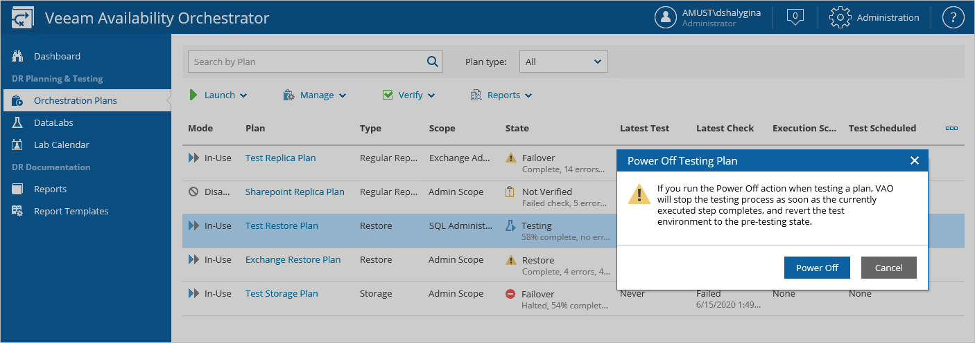

    To cancel testing of a restore plan:
    1. Select the plan. From the Verify menu, select Power Off DataLab Test.
    -OR-
    Right-click the plan name and select Verify > Power Off DataLab Test.
    1. In the Power Off Testing Plan window, click Power Off to confirm the action.
