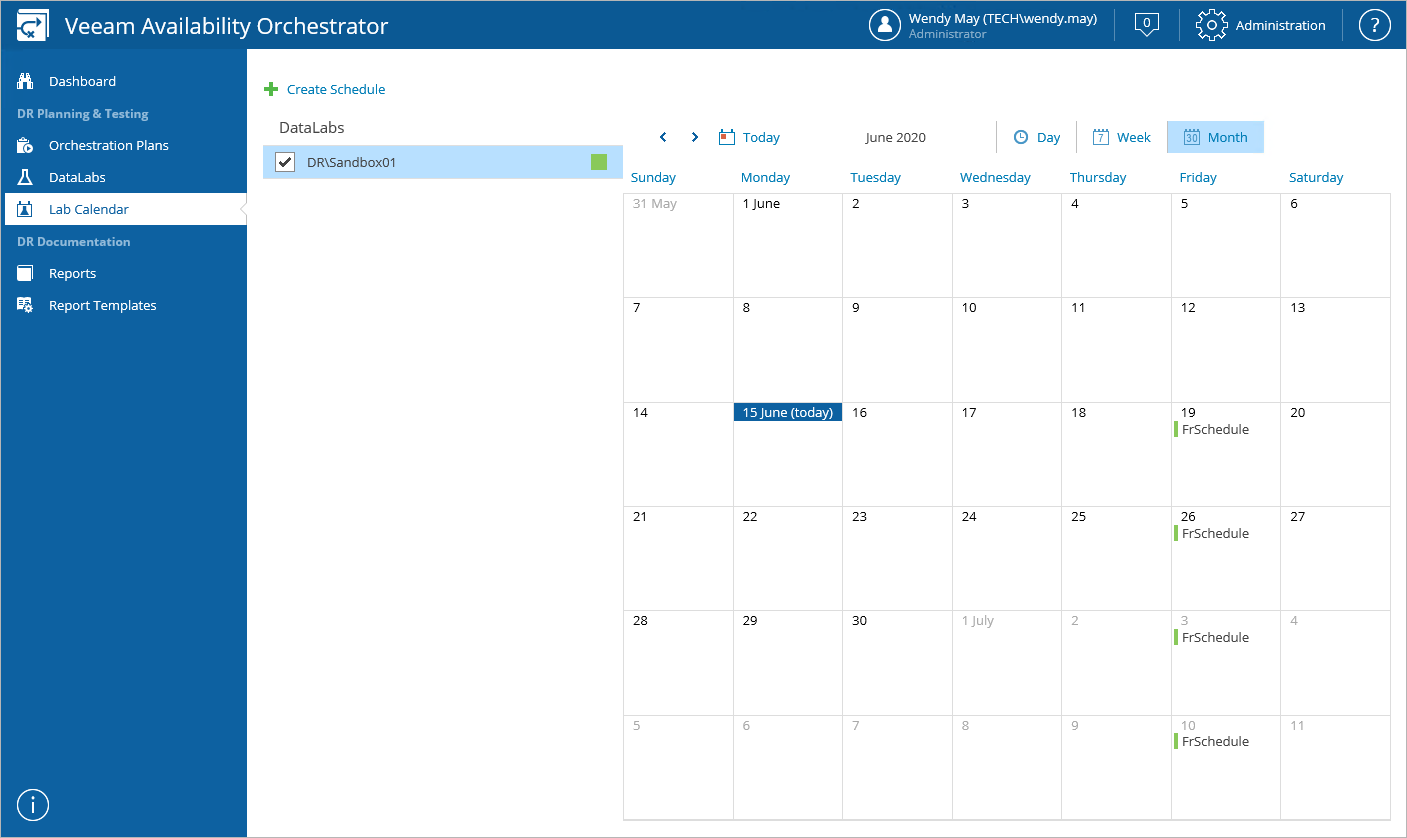

    The created schedule will be displayed in the calendar.
    You can delete a configured schedule if you no longer need it. To do that, select the schedule in the calendar, and click Delete at the Details step of the Edit Test Schedule wizard.

    When the scheduled day and time comes, VAO will power on the lab, start lab groups and begin testing the selected plans. To track lab progress, switch to the DataLab Details page.
    As soon as the test is over, the DataLab Test Report will be generated. The plans and the DataLab will be powered off or will keep running, depending on the power options chosen in the Create Test Schedule wizard.
