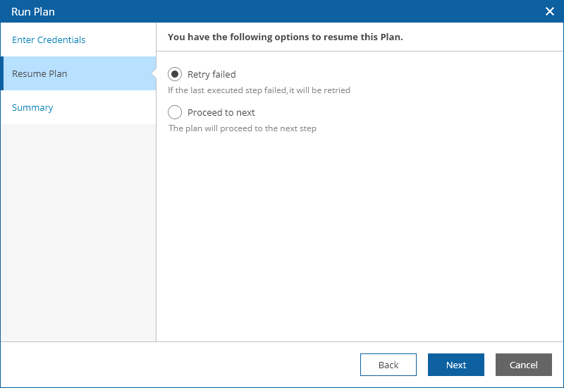

    Running Halted Replica Plan
    1. At the Resume Plan step, select an option to resume plan execution.
    Choose whether you want to proceed with plan execution from the next plan step or to retry the failed step.
    1. At the Summary step, review configuration information and click Finish. The failover process will be started.
