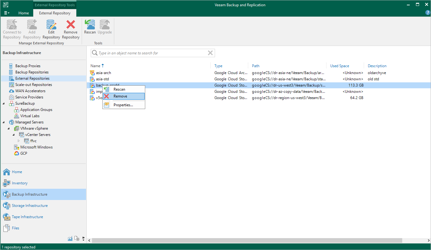

Removing Backup Repositories Using Console
Google Cloud Plug-in for Veeam Backup & Replication allows you to permanently remove repositories from the backup infrastructure:
  2. Navigate to External Repositories.
  3. Select the necessary repository and click Remove Repository on the ribbon.
Alternatively, you can right-click the repository and select Remove.
If you remove a backup repository using the Veeam Backup & Replication console, Veeam Backup & Replication will not propagate these settings to the backup appliance automatically. Consider removing the repository manually as described in section Removing Backup Repositories Using Veeam Backup for Google Cloud Web UI.
Remove repository
