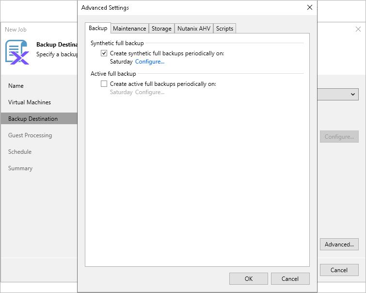

Configuring Advanced Settings
To configure advanced settings for the backup job, do the following:
  1. Click Advanced.
  2. To schedule synthetic full backups, on the Backup tab of the Advanced settings window, select the Create synthetic full backups periodically check box, click Configure and choose whether you want to create synthetic full backups on specific days every week or on specific days of specific months.
  3. To schedule active full backups, on the Backup tab of the Advanced settings window, select the Create active full backups periodically check box, click Configure and choose whether you want to create active full backups on specific days every week or on specific days of specific months.
Alternatively, you can create active full backups manually when needed. For more information, see Creating Active Full Backup.
Do not schedule synthetic and active full backups to run at the same time. Due to technical limitations, Veeam Backup for Nutanix AHV will be unable to create synthetic full backups according to the specified schedule.
