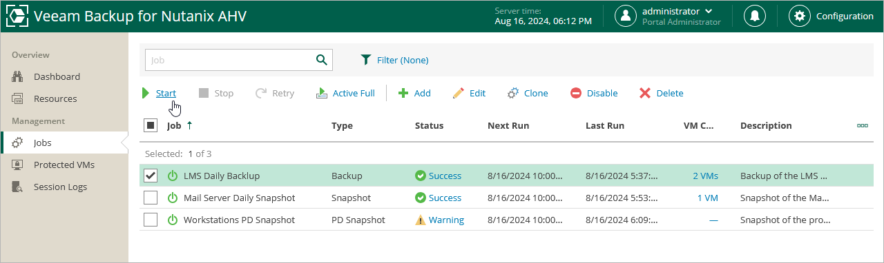

To start or stop a job, do the following:
  1. Navigate to Jobs.
  2. Select the job.
  3. Click Start or Stop.
Starting and Stopping Jobs
You can also start or stop a job using the Veeam Backup & Replication console. To do that, in the inventory pane of the Home view, select Jobs > Backup, select the job and click Start or Stop on the ribbon.
