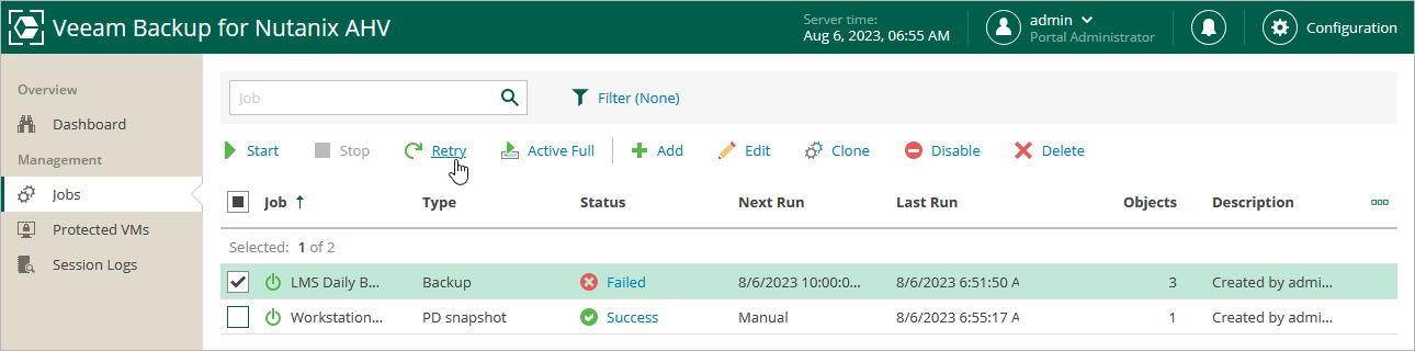

If a job fails, you can retry the backup operation. When you perform a retry, Veeam Backup for Nutanix AHV restarts the operation only for the failed resources added to the job and does not process VMs that have been processed successfully. As a result, retrying a job takes less time compared to restarting the job for all resources.
To retry a job, do the following:
  1. Navigate to Jobs.
  2. Select the failed job.
  3. Click Retry.
Retrying Job
You can also retry a job using the Veeam Backup & Replication console. To do that, in the inventory pane of the Home view, select Jobs > Backup, select the job and click Retry on the ribbon.
