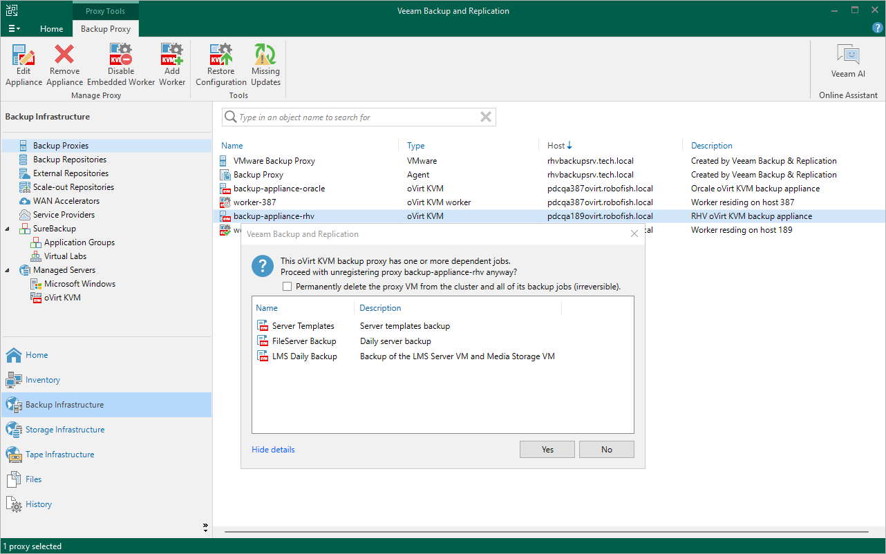

To remove the backup appliance, do the following:
  2. In the inventory pane, select Backup Proxies.
  3. In the working area, select the backup appliance and click Remove Appliance on the ribbon.
Alternatively, right-click the backup appliance and select Remove.
  1. In the Veeam Backup & Replication window, choose whether you want to permanently remove from the host the VM running as the backup appliance.
If you keep the VM, the configuration settings and records about backup jobs ever processed by the appliance will be retained in the appliance database. This can be helpful if you want to connect the backup appliance to another backup server.
