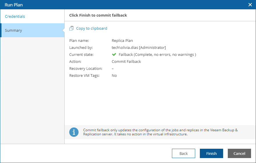

  1. Complete the Run Plan wizard:
  1. For security purposes, at the Credentials step, retype your password.
Committing Failback
  1. At the Summary step, review configuration information and click Finish.
