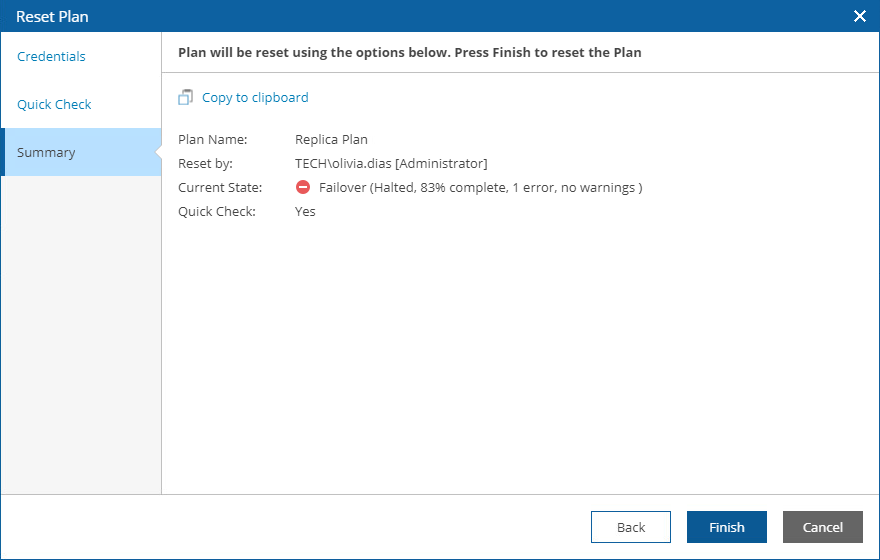

  1. Complete the Reset Plan wizard:
  1. For security purposes, at the Credentials step, retype your password.
Resetting Replica Plan
  1. At the Quick Check step, select the Perform a Quick Check after reset is complete check box to run a readiness check after the rest.
  1. At the Summary step, review configuration information and click Finish.
