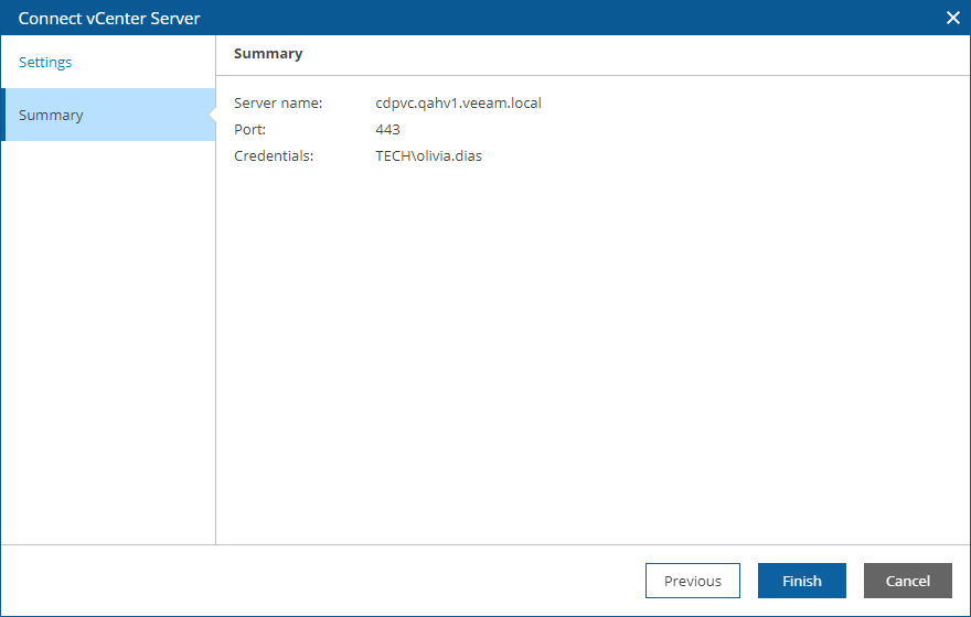

Connecting VMware vSphere Server
  1. At the Summary step of the wizard, review the connection details and click Finish.
