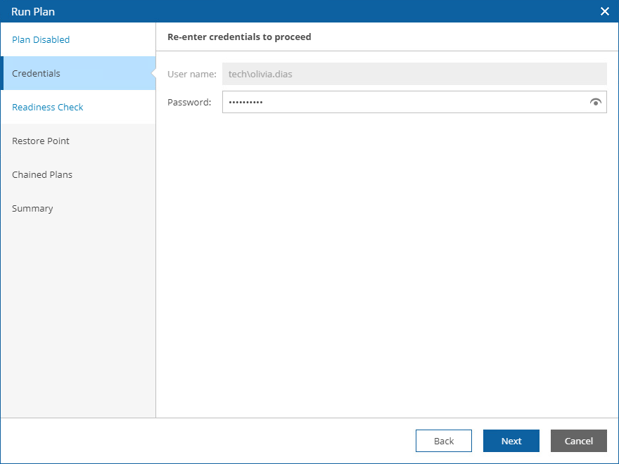

  1. For security purposes, at the Credentials step, retype your password.
Running Failover
