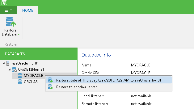

With 1-Click Restore, Veeam Explorer for Oracle allows you to quickly restore a database to the original location (that is, the original Oracle server hosting the database). You can restore selected database to the current state, or to the certain point in time - for that, make sure the Oracle backup job was set up properly (see Required Oracle Server Backup Job Settings) and completed successfully.
To launch 1-Click Restore to original server, in the navigation tree select the database you need, then from the shortcut menu select Restore state of <date_time> or latest state to <server>. You can also use the similar command from the ribbon menu.
