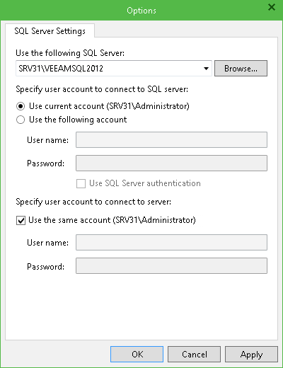

Setting Up a Staging Server
To specify a staging server, do the following:
- Launch Veeam Explorer for Microsoft SQL Server, open the main menu and click Options.
- Select the necessary SQL Server instance (local or remote) from the list.
- Specify user account that will be used to access this SQL server - this can be current account (the one under which Veeam Explorer is running) or another account.
- Specify account that will be used to access Windows machine where that SQL server runs. You can also use current account or another account.
