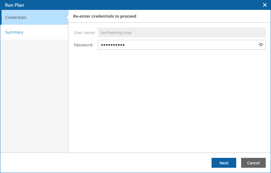

  1. Complete the Run Plan wizard:
  1. For security purposes, at the Credentials step, retype your password.

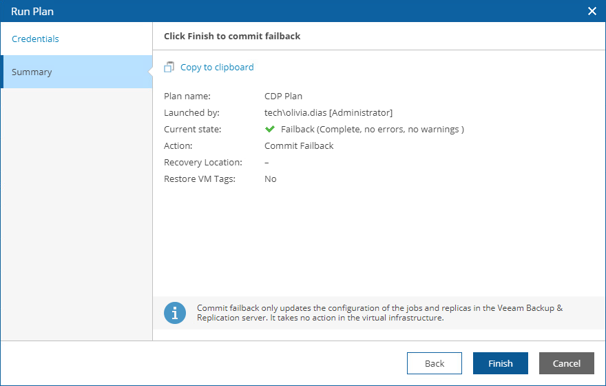

Committing Failback
  1. At the Summary step, review configuration information and click Finish.
Committing Failback
After the commit failback process completes, Orchestrator will leave the plan in the IN-USE mode. By design, this makes the results of the commit failback process accessible in the Orchestrator UI as long as required, and also prevents the plan from being modified by any automatic updates related to infrastructure changes.
If you want to perform any further actions with the plan (for example, to run readiness checks or to execute the plan again), reset the plan as described in section Resetting CDP Replica Plans.
