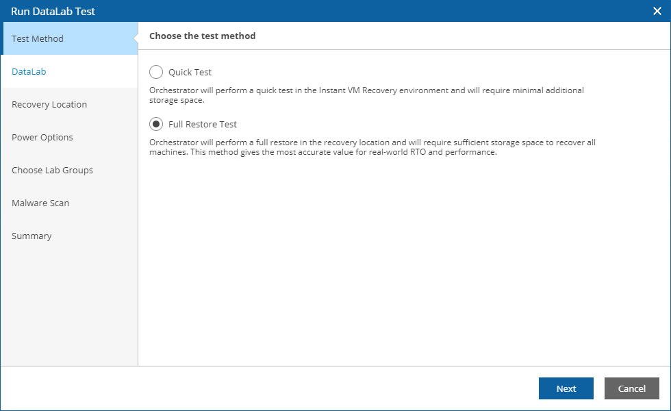

Step 1. Choose Test Method
At the Test Method step of the wizard, choose whether you want to verify both backups of plan machines and the recovery location used to restore the machines, or backups only.
  • If you select the Quick Test option, Orchestrator will verify whether machines included in the plan will be able to recover from their backup files.
In this case, plan machines will be verified in the Instant VM Recovery environment.
  • If you select the Full Restore Test option, Orchestrator will not only verify that vSphere and agent backups are ready-to-use, but also check that the recovery location to which the machines will be restored is available and has enough resources to support the recovery process.
In both cases, Orchestrator will run all verification steps added to the plan to make sure that the plan will be able to complete successfully.
