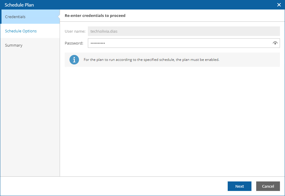

  1. For security purposes, at the Credentials step, retype your password.

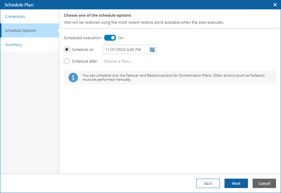

  1. At the Schedule Options step, set the Scheduled execution toggle to On, and choose whether you want to run the plan on schedule or after any other plan.
  • If you want to run the plan at a specific time, select the Schedule on option, click the Schedule icon, set the desired date and time, and click Apply.
  • If you want to run the plan after another plan, select the Schedule after option and click Choose a Plan. Then, in the Select Plan window, select the necessary plan and click OK.

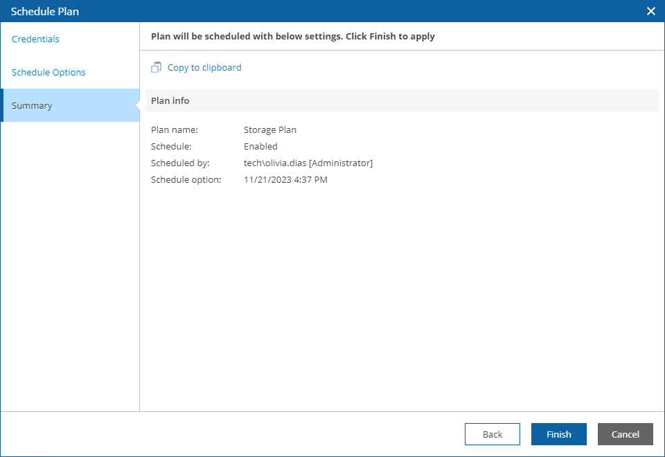

  1. At the Summary step, review configuration information and click Finish.
