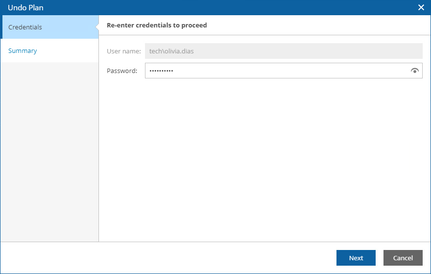

  1. Complete the Undo Plan wizard:
  1. For security purposes, at the Credentials step, retype your password.
Undoing Failover

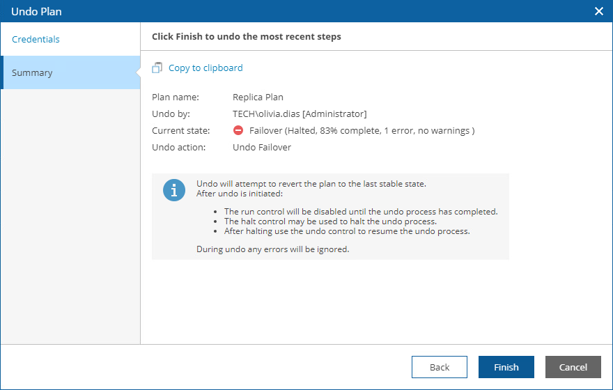

  1. At the Summary step, review configuration information and click Finish.
Undoing Failover
If the undo failover process encounters an error while being performed, it will not be halted automatically — the plan will proceed until the process completes. To terminate the undo failover process manually, use the Halt option to stop the currently running plan as described in section Halting Failover. To resume the undo failover process again, use the Undo option.
