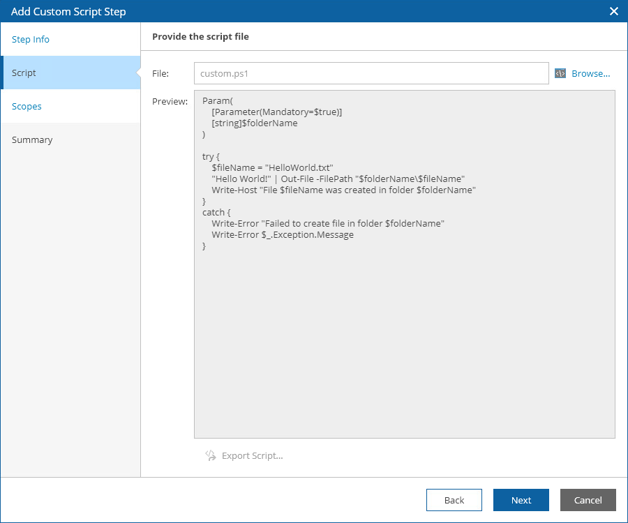

  1. At the Script step, browse to the script file.
Creating Custom Script Step

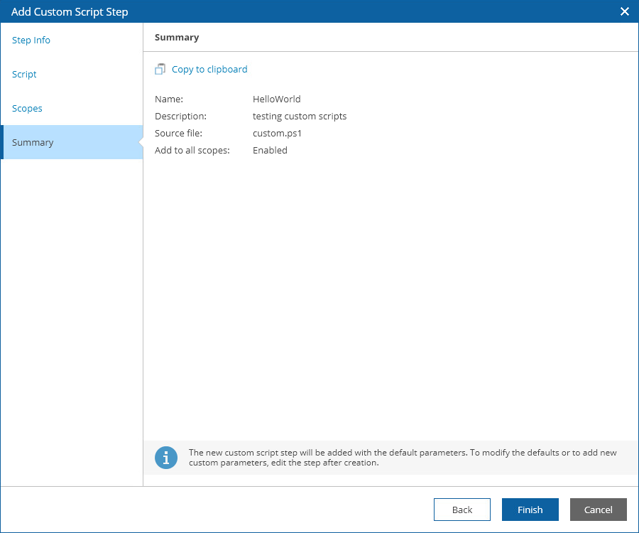

  1. At the Summary step, review configuration information and click Finish.
