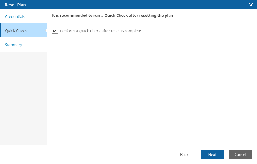

  1. At the Quick Check step, select the Perform a Quick Check after reset is complete check box to run a readiness check after the reset.

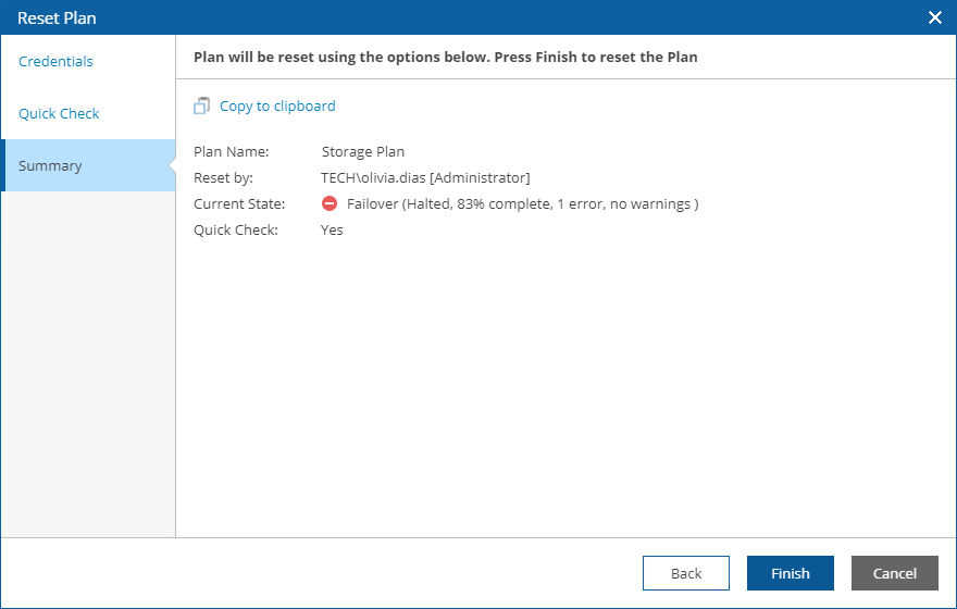

Resetting Storage Plan
  1. At the Summary step, review configuration information and click Finish.
