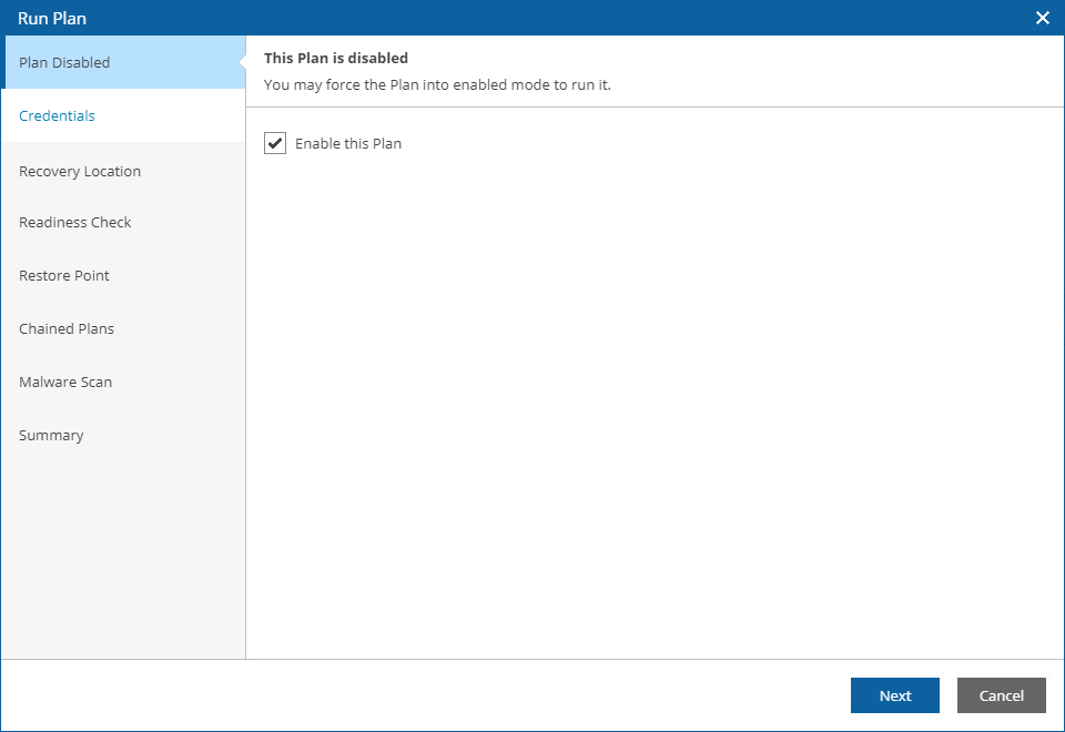

  1. [This step applies only if you have not enabled the plan before running it]
At the Plan Disabled step, select the Enable this Plan check box.

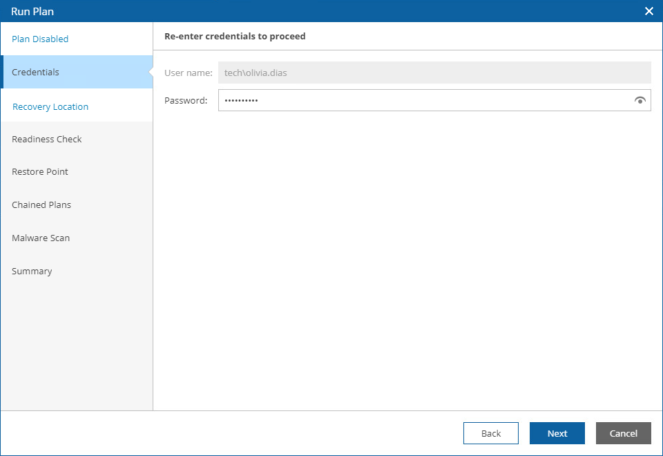

  1. For security purposes, at the Credentials step, retype your password.
Running Restore

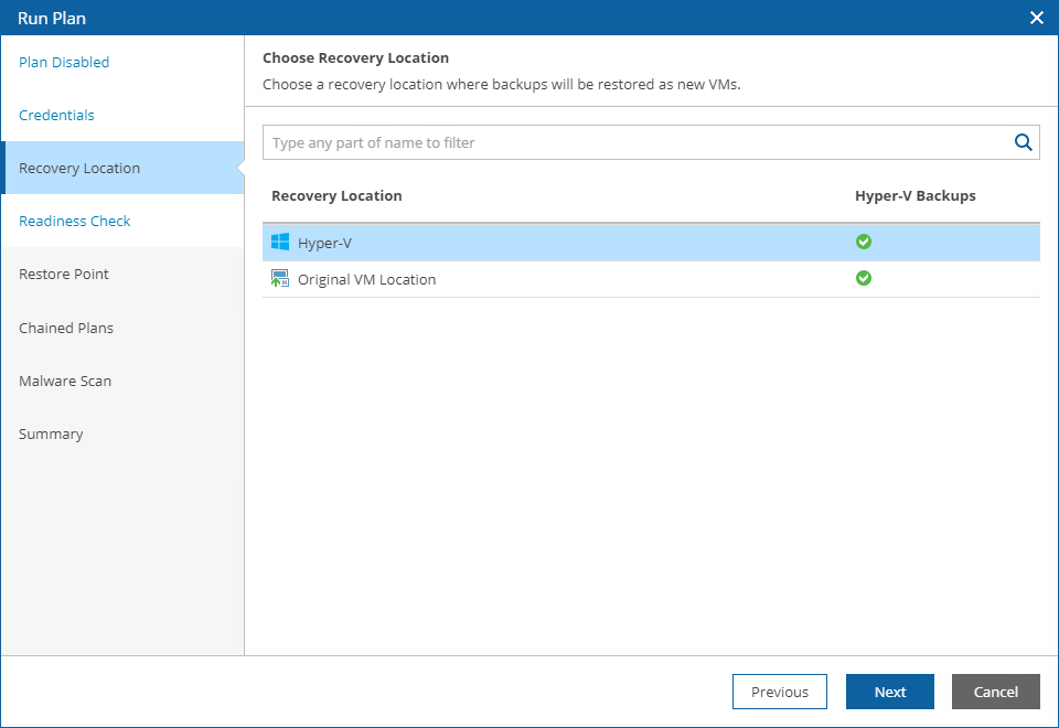

  1. At the Recovery Location step, select a location to which inventory groups included in the plan will be restored.
For a recovery location to be displayed in the list of available locations, it must be created and added to the list of inventory items available for the scope, as described in section Managing Recovery Locations.
If the restore plan contains a VM that still exists in the selected Hyper-V location, Orchestrator will make an attempt to replace the original VM with the restored one. If the target VM is powered on, the restore operation will complete with an error. To avoid this, power all the plan VMs off — and then try running the plan again.
Running Restore
If the selected recovery location includes multiple hosts, datastores and networks, Orchestrator will use the round-robin algorithm to restore machines added to the plan. For more information, see How Orchestrator Places VMs During Restore.

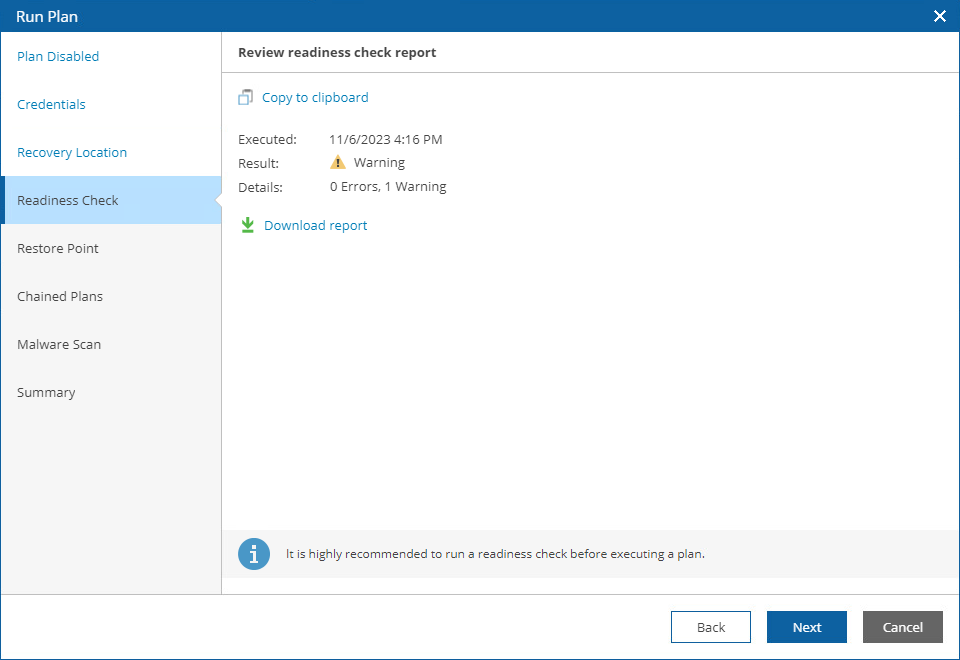

  1. At the Readiness Check step, review the results of the most recent readiness check run for the plan to make sure the plan will be able to complete successfully.
Running Restore

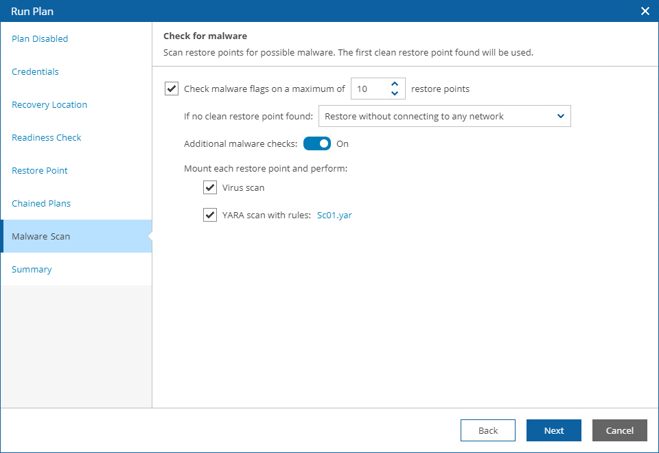

  1. At the Malware Scan step, choose whether you want to check restore points created for machines included in the plan for malware flags. When restoring to a VMware vSphere environment, you can also decide whether you want to scan these restore points with antivirus software, YARA rules or both.
By default, Orchestrator checks a maximum of 10 recently created restore points for each machine. If all the restore points are infected, Orchestrator restores the machine to the selected recovery location without connecting it to any network. However, you can instruct Orchestrator to halt the plan and cancel the restore operation if no clean restore point is found.
For more information on how Orchestrator performs malware scan, see Overview.
Running Restore

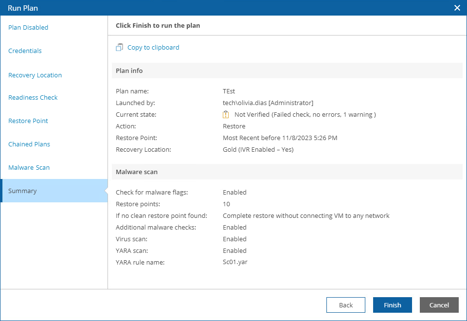

  1. At the Summary step, review configuration information and click Finish.
Running Restore
