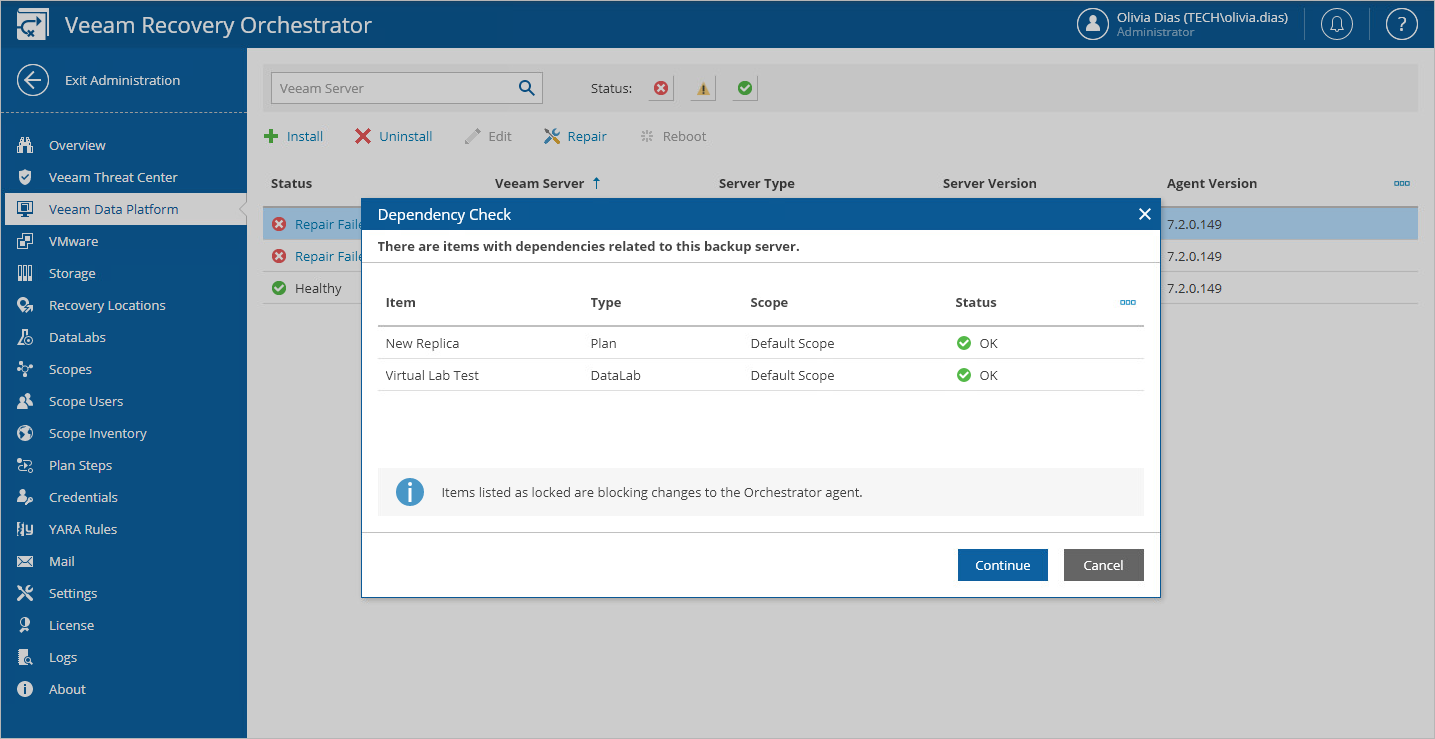

  1. Select the Orchestrator agent and click Uninstall.
  2. The Dependency Check window will inform you if any DataLabs or recovery plans are related to the Veeam Backup & Replication server.
  • If any of the items occur to be Locked, Orchestrator will not be able to uninstall the Orchestrator agent.
In this case, wait until Orchestrator stops processing the items, power off plan testing in the locked DataLabs, reset the locked recovery plans — and then try uninstalling the Orchestrator agent again.
  • If none of the items are Locked, click Continue to confirm the operation.
As soon as you uninstall the Orchestrator agent from the Veeam Backup & Replication server, all its related recovery plans will no longer be able to run, and all its related DataLabs will be removed from Orchestrator.

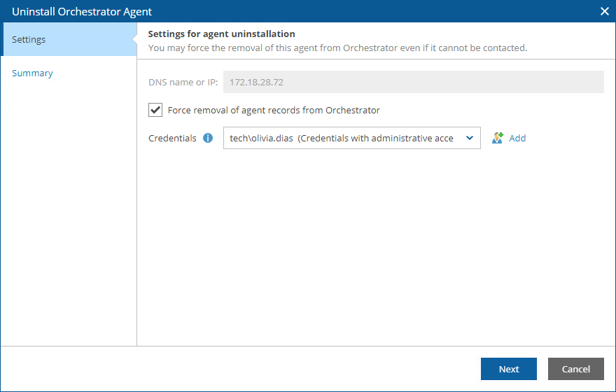

  1. At the Settings step of the wizard, specify the following settings:
  1. Choose whether you want to uninstall the Orchestrator agent regardless of the Veeam Backup & Replication server state.
If Orchestrator is not able to access the server, the Orchestrator agent will be removed from the Orchestrator database but will keep running on the Veeam Backup & Replication server.
  1. From the Credentials drop-down list, select the necessary account for connecting to the server. For an account to be displayed in the Credentials list, it must be added to the configuration database as described in section Adding Credentials. If you have not set up an account beforehand, click Add and follow the steps of the Add Credential wizard. For more information on the required account permissions, see Permissions.
The provided credentials will be also used to launch the Orchestrator agent on the server. The user name must be specified in the DOMAIN\USERNAME or USERNAME format.

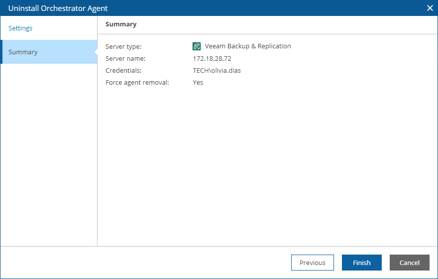

  1. At the Summary step, review the configured settings and click Finish.
