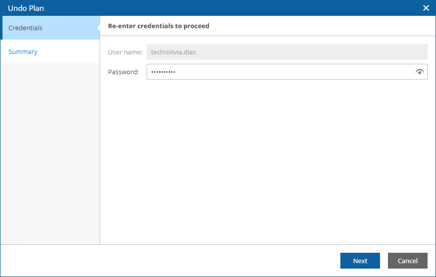

  1. Complete the Undo Plan wizard:
  1. For security purposes, at the Credentials step, retype your password.
Undoing Halted Plan

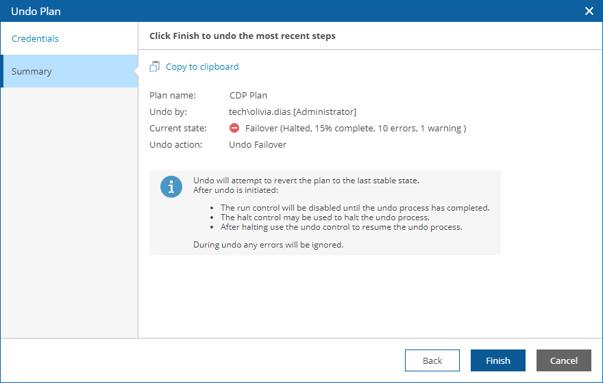

  1. At the Summary step, review configuration information and click Finish. The failover process will be started.
Undoing Halted Plan
