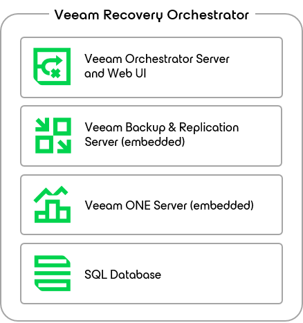

Veeam Orchestrator Server
The Orchestrator server is the configuration, administration and management core of the Orchestrator architecture. This is where recovery plans are created, audited, tested and executed. Internally, the Orchestrator server is comprised of the following components:
All Orchestrator components can be deployed on a single Windows-based physical or virtual machine using the unified installer.
Installation of the Orchestrator server on a machine already running Veeam Backup & Replication or Veeam ONE is not supported.
