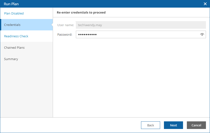

  1. For security purposes, at the Credentials step, retype your password.
Running Storage Failover

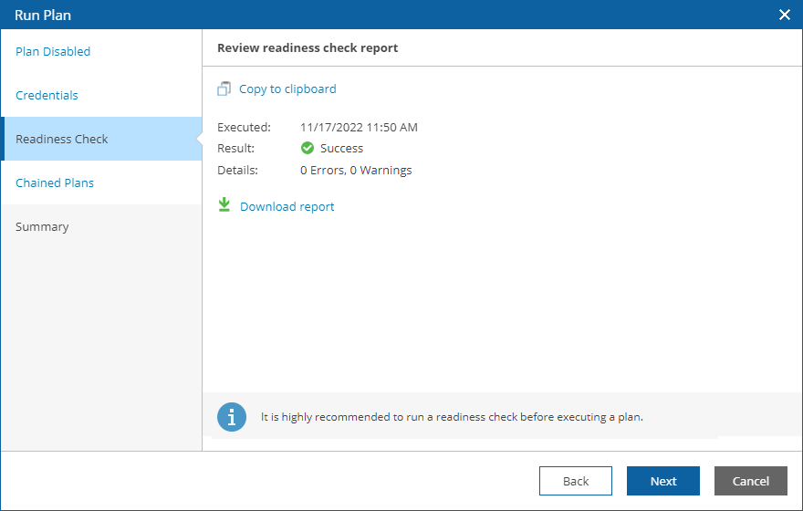

  1. At the Readiness Check step, review the results of the most recent readiness check run for the plan to make sure the plan will be able to complete successfully.

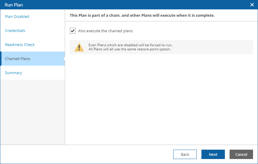

  1. [This step applies only if you have any other recovery plans scheduled to run after the plan completes]
At the Chained Plans step, select the Also execute the chained plans check box to proceed to the execution of subsequent plans after the current plan enters the FAILOVER state.

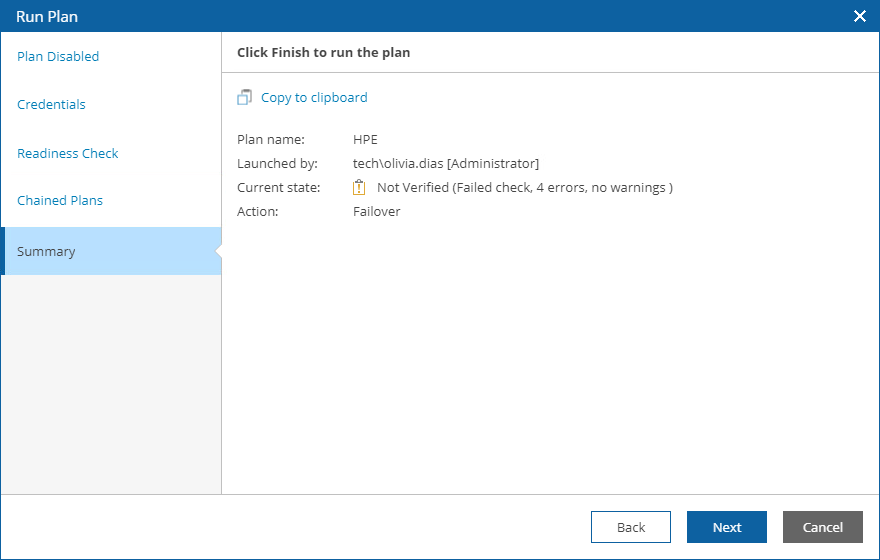

  1. At the Summary step, review configuration information and click Finish.
