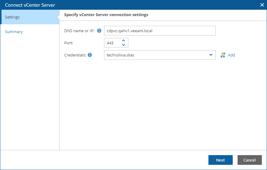

  1. At the Settings step of the wizard, specify the following connection settings:
  1. Use the DNS name or IP field to enter a DNS name or an IPv4 address of the vCenter Server that will be connected to the Orchestrator agent. The maximum length of the location name is 256 characters; the following characters are not supported: * : / \ ? @ [ ] ; : = + " < > | .
If you want to add an vCenter Server that is part of a backup infrastructure already connected to Orchestrator, make sure that you add the server using the same DNS name or IPv4 address as in the backup infrastructure to avoid synchronization issues.
  1. From the Credentials drop-down list, choose the necessary account for connecting to the server. For an account to be displayed in the Credentials list, it must be added to the configuration database as described in section Adding Credentials. If you have not set up an account beforehand, click Add and follow the steps of the Add Credential wizard. For more information on the required account permissions, see Permissions.
  2. If required, change the port number used for communication with the server.
If an untrusted security certificate is installed on the vCenter Server, you will get a security warning. You can view the certificate and click Remember and Continue — in this case, Orchestrator will remember the certificate thumbprint and will further trust the certificate when connecting to the server. Otherwise, you will not be able to add the server.
Connecting VMware vSphere Server

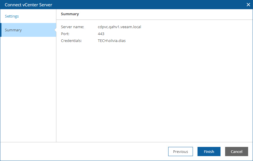

  1. At the Summary step of the wizard, review the connection details and click Finish.
