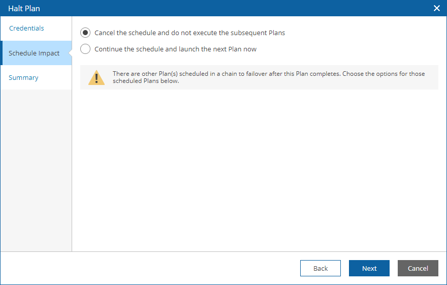

  1. [This step applies only if you have any other recovery plans scheduled to run after the plan completes]
At the Schedule Impact steps, choose whether you want to proceed with or cancel execution of subsequent plans after the current plan enters the HALTED state.

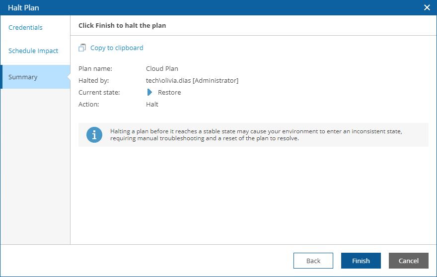

  1. At the Summary step, review configuration information and click Finish.
