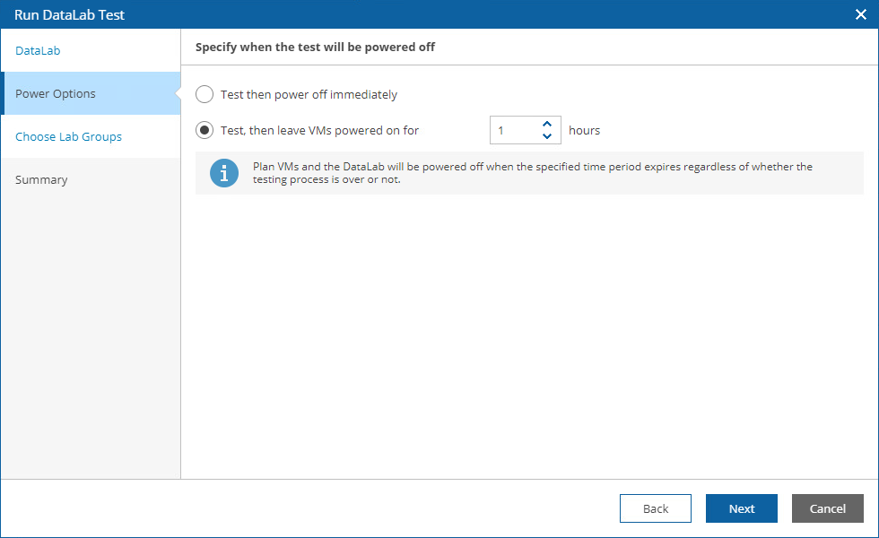

Step 2. Choose Power Options
At the Power Options step of the wizard, choose an action to perform after the plan testing process is over:
  • To power off all plan VMs and the lab, select the Test then power off immediately option.
  • To keep all plan VMs and the lab running in case you are willing to perform further tests, select the Test, then leave VMs powered on for option.
Use the Test, then leave VMs powered on for field to book a time slot in the lab schedule and prevent other tests from being scheduled for the same period.
If you have selected a starting or running lab at the DataLab step of the wizard, the lab will not be powered off after the plan testing process is over — even if the Test then power off immediately option is selected. In this case, Orchestrator will power off only plan VMs and keep the lab running.
