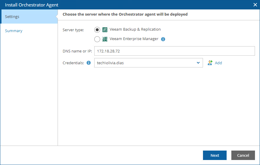

  1. At the Settings step of the wizard, specify the following connection settings:
  1. Use the Server type options to specify whether the server is a Veeam Backup & Replication server or Veeam Backup Enterprise Manager server.
If you choose the Veeam Enterprise Manager option, Orchestrator agents will be deployed to all Veeam Backup & Replication servers managed by the Veeam Backup Enterprise Manager.
  1. Use the DNS name or IP field to enter a DNS name or an IPv4 address of the server where you want to deploy the Orchestrator agent. The maximum length of the location name is 256 characters; the following characters are not supported: * : / \ ? @ [ ] ; : = + " < > | .
  2. From the Credentials drop-down list, choose the necessary account for connecting to the server. For an account to be displayed in the Credentials list, it must be added to the configuration database as described in section Adding Credentials. If you have not set up an account beforehand, click Add and follow the steps of the Add Credentials wizard. For more information on the required account permissions, see Permissions.
The provided credentials will be also used to launch the Orchestrator agent on the server. The user name must be specified in the DOMAIN\USERNAME or USERNAME format.
If you want to connect an Enterprise Manager server, you must specify the credentials that were used when installing Veeam Backup Enterprise Manager.
Connecting Veeam Backup & Replication Server

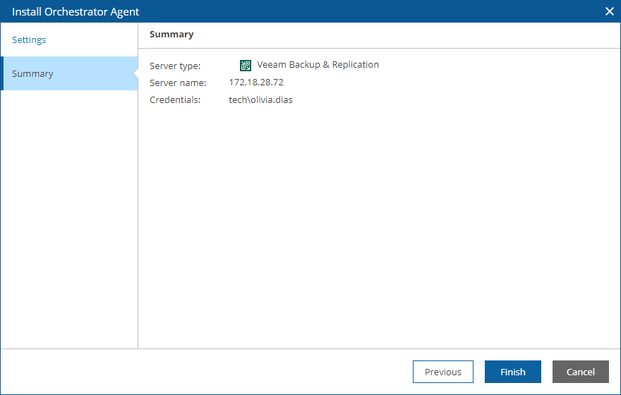

  1. At the Summary step of the wizard, review the connection details and click Finish.
