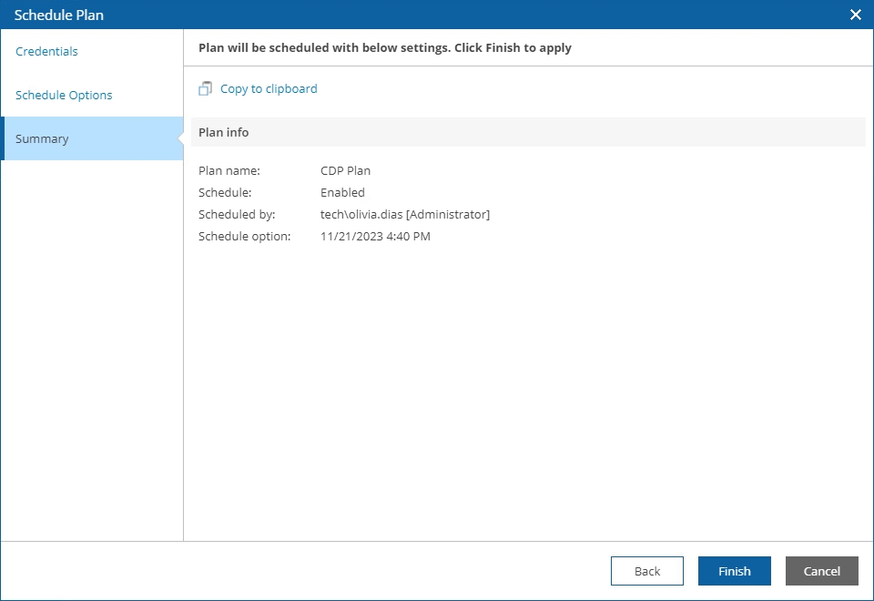

Scheduling Failover
  1. At the Summary step, review configuration information and click Finish.
