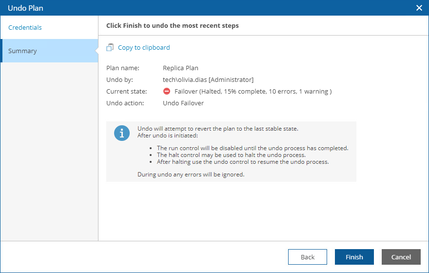

To perform an undo operation for a HALTED replica plan:
  2. Select the plan. From the Launch menu, select Undo.
-OR-
Click the plan name to switch to the Plan Details page, and click Undo.
  1. Complete the Undo Plan wizard:
  1. For security purposes, at the Credentials step, retype your password.
Undoing Halted Plan
  1. At the Summary step, review configuration information and click Finish. The failover process will be started.
Undoing Halted Plan
If a plan repeatedly enters the HALTED state due to misconfiguration or changes in the external environment, the only option left may be to RESET the plan.
