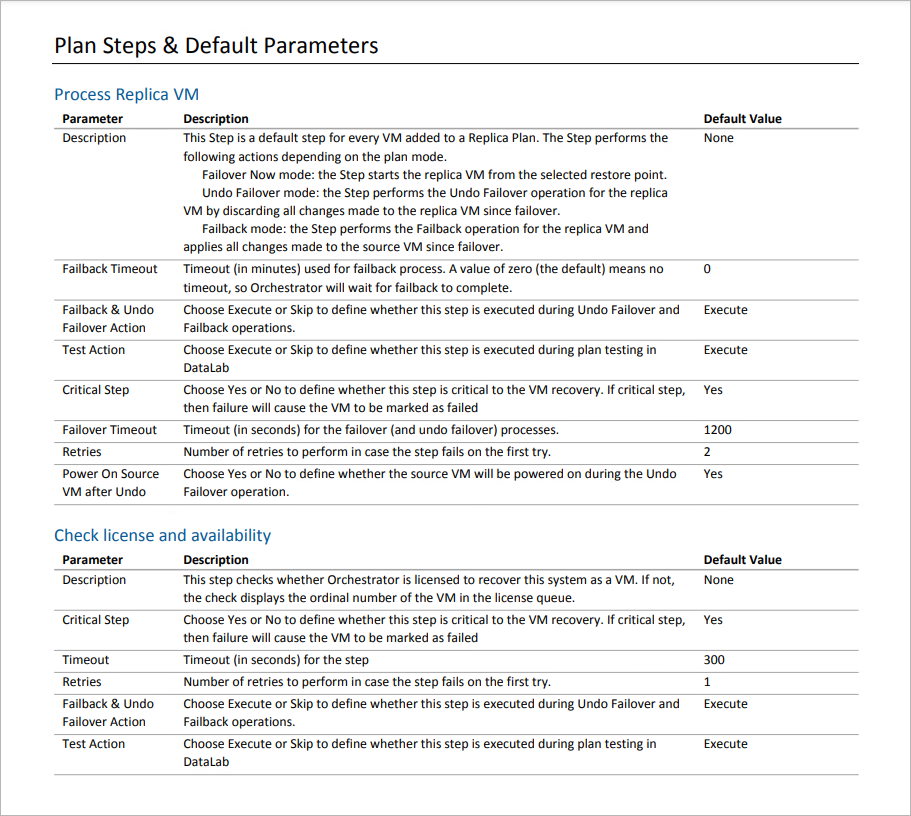

Orchestrator generates two types of reports:
  • A summary report that includes a plan overview and a summary of inventory groups included in the plan with drill-down hyperlinks to individual machines.
  • A full report that also includes details on the recovery location specified for the plan, information on specific steps that will run during the recovery process and the plan change log, which allows you to track who changed plan settings, when and what was changed.

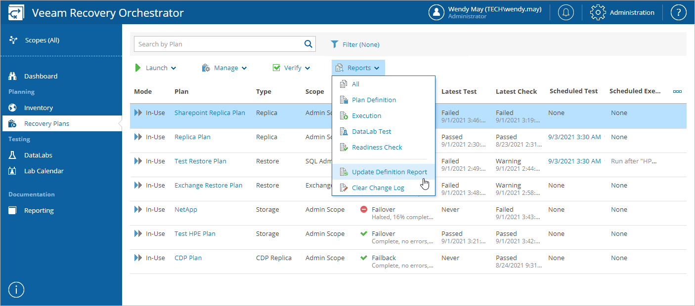

By default, Orchestrator runs the Plan Definition Report automatically for every ENABLED recovery plan at 7:00 AM daily. You can also generate the report for a plan on demand:
  2. Select the plan.
  3. From the Reports menu, select Update Definition Report.
-OR-
Right-click the plan and select Update Definition Report from the drop-down menu.
The Update Definition Report link will be unavailable in case the plan is being edited.

The Plan Definition Report will use the default report template or a custom template. The plan definition will be appended at the end of the template.

The plan change log may grow very large over time. To clear the change log history, do the following:
  1. Select the plan. From the Reports menu, select Clear Change Log.
-OR-
Right-click the plan name and select Reports > Clear Change Log.
