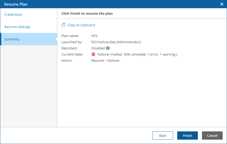

Running Halted Storage Plan
  1. At the Summary step, review configuration information and click Finish. The failover process will be started.
