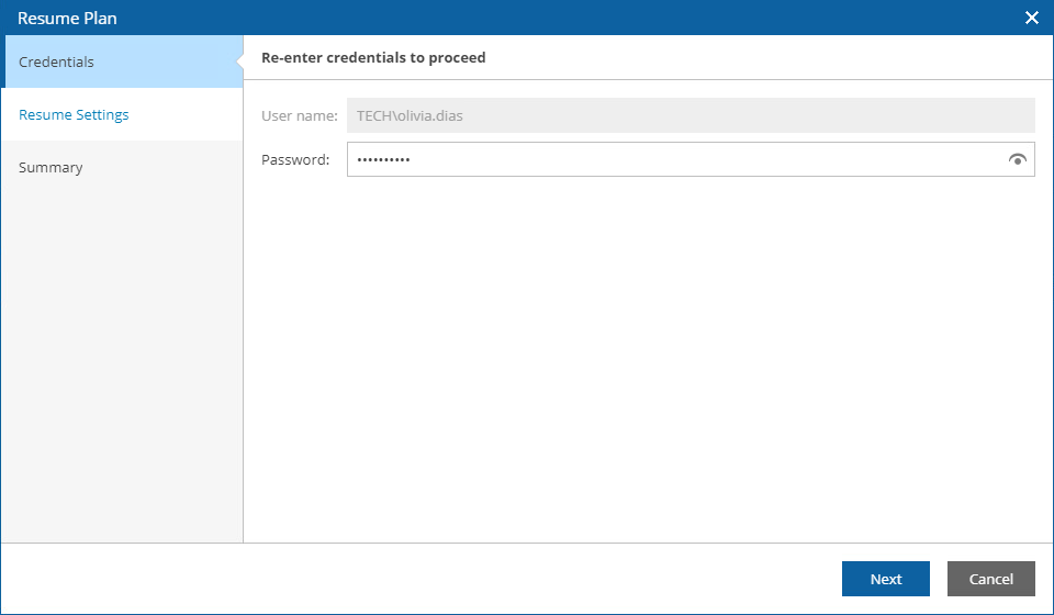

  1. Complete the Resume Plan wizard:
  1. For security purposes, at the Credentials step, retype your password.

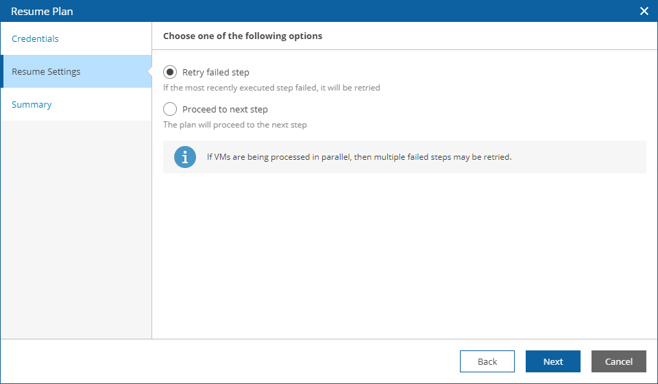

  1. At the Resume Settings step, select an option to resume plan execution.
Choose whether you want to proceed with plan execution from the next plan step or to retry the failed step.

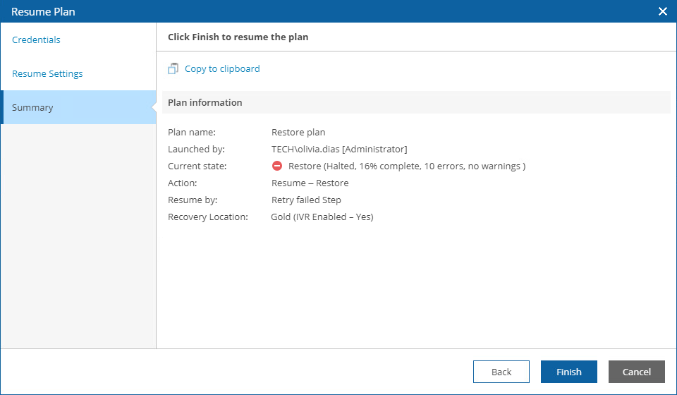

  1. At the Summary step, review configuration information and click Finish. The restore process will be started.
