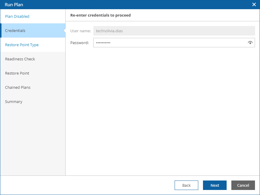

Running Failover
  1. For security purposes, at the Credentials step, retype your password.

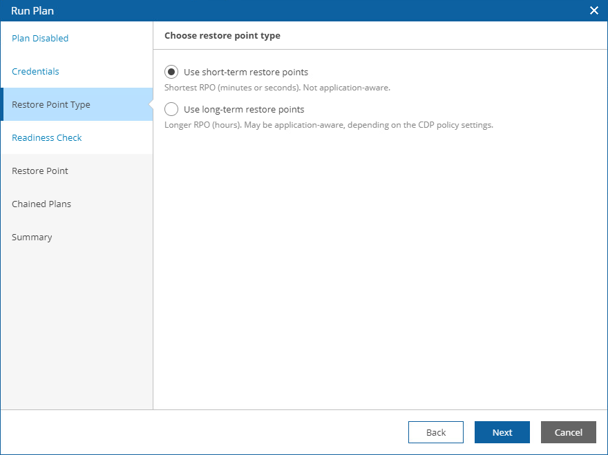

Running Failover
  1. At the Restore Point Type step, choose whether you want to use a short-term or long-term restore point to recover VM replicas:
  • Short-term restore points are replicated states that are created with the shortest RPO (several seconds or minutes) and stored according to the short-term retention settings (no longer than several hours).
  • Long-term restore points are restore points that are created with a longer RPO (several hours) and stored according to the long-term retention settings (up to several days). Depending on the specified CDP policy settings, long-term restore points can be application-consistent and crash-consistent.
For more information on CDP retention policies, see the Veeam Backup & Replication User Guide, section Creating CDP Policies.

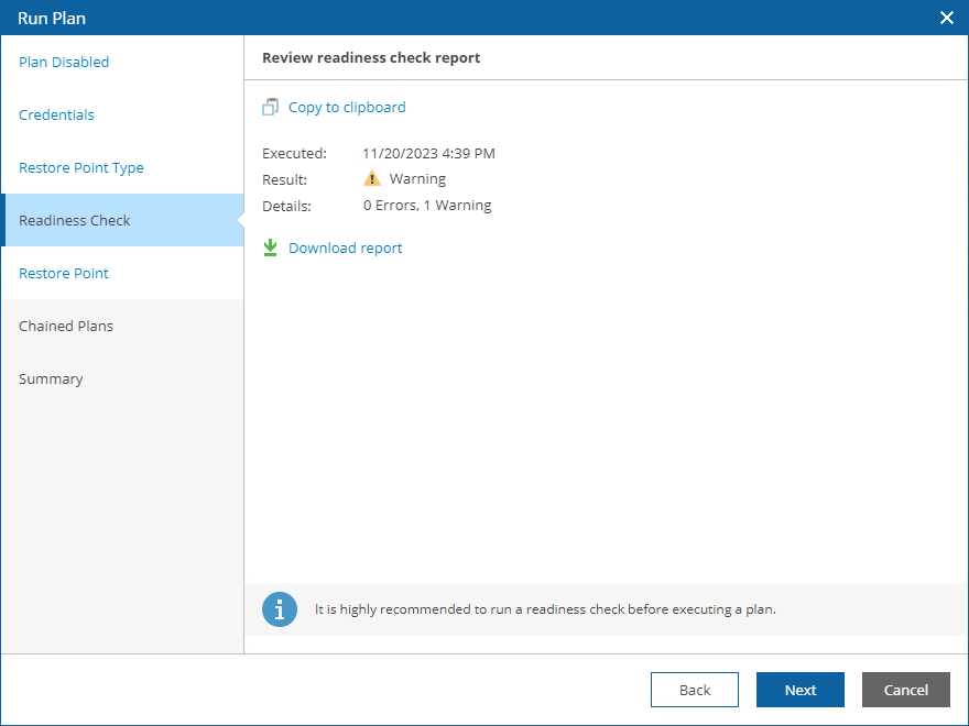

Running Failover
  1. At the Readiness Check step, review the results of the most recent readiness check run for the plan to make sure the plan will be able to complete successfully.

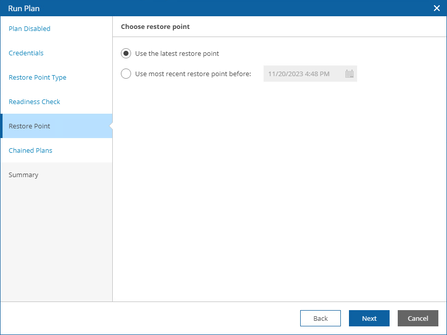

Running Failover
  1. At the Restore Point step, choose a restore point that will be used to recover VM replicas.

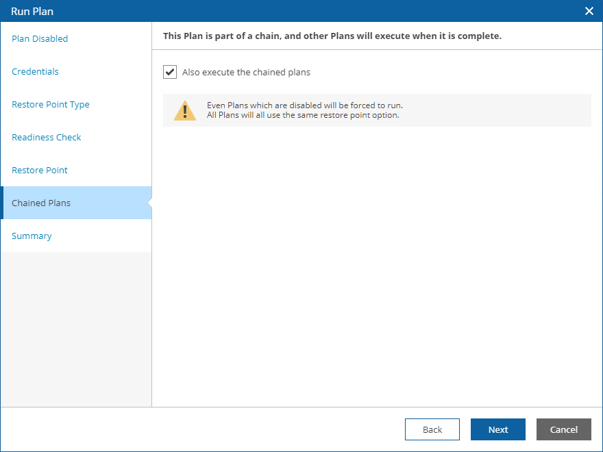

Running Failover
  1. [This step applies only if you have any other recovery plans scheduled to run after the plan completes]
At the Chained Plans step, select the Also execute the chained plans check box to proceed to the execution of subsequent plans after the current plan enters the FAILOVER state.

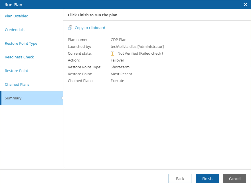

Running Failover
  1. At the Summary step, review configuration information and click Finish.
Running Failover
