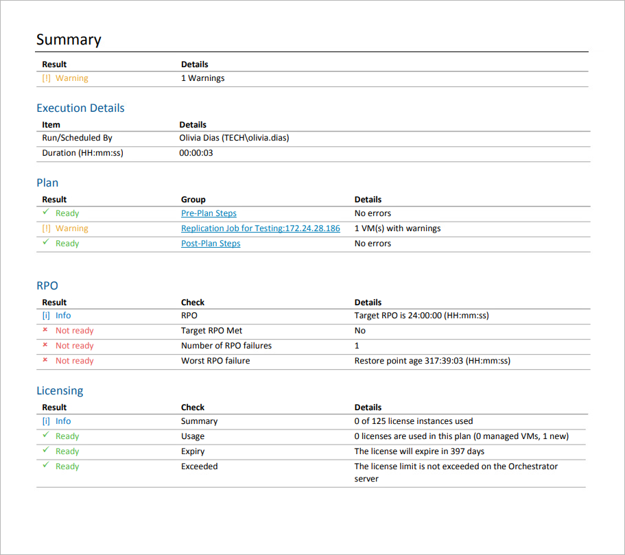

Orchestrator generates two types of reports:
  • A summary report that includes a plan overview and a summary of inventory groups included in the plan with drill-down hyperlinks to specific machines and color-coded results of checking every plan step.
  • A full report that also includes details on the recovery location specified for the plan and information on specific steps that will run during the recovery process.

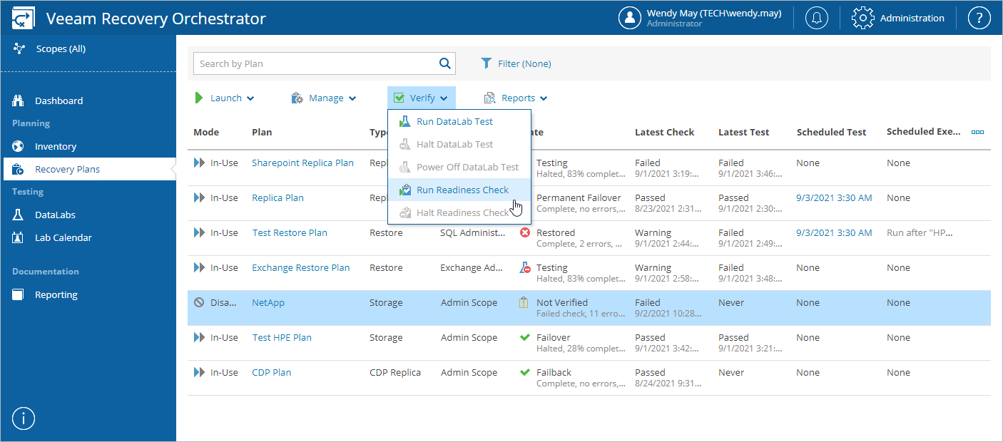

Running Plan Readiness Check Manually
By default, Orchestrator runs the readiness check automatically for every ENABLED recovery plan at 8:00 AM daily. To run the check manually for a plan:
  2. Select the plan.
  3. From the Verify menu, select Run Readiness Check.
-OR-
Right-click the plan and select Run Readiness Check from the drop-down menu.
  1. In the Run Readiness Check window, click OK.
As soon as the readiness check completes, the State and Latest Check columns will display the check result. The state information (Verified, Needs Verified or Not Verified) is a rollup of the Readiness Check and DataLab test results.

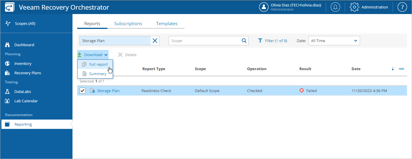

Downloading Plan Readiness Check Reports
To view details of the readiness check for a recovery plan:
  1. On the Recovery Plans page, select the plan.
  2. From the Reports menu, select Readiness Check.
The Reports page with all Readiness Check Reports available for the plan will be displayed.
  1. Click the plan name to download a summary report.
-OR-
Click Download and choose whether you want to download a summary or full report.

The Readiness Check Report will use the default report template or a custom template. The results of all readiness checks will be appended at the end of the template.
