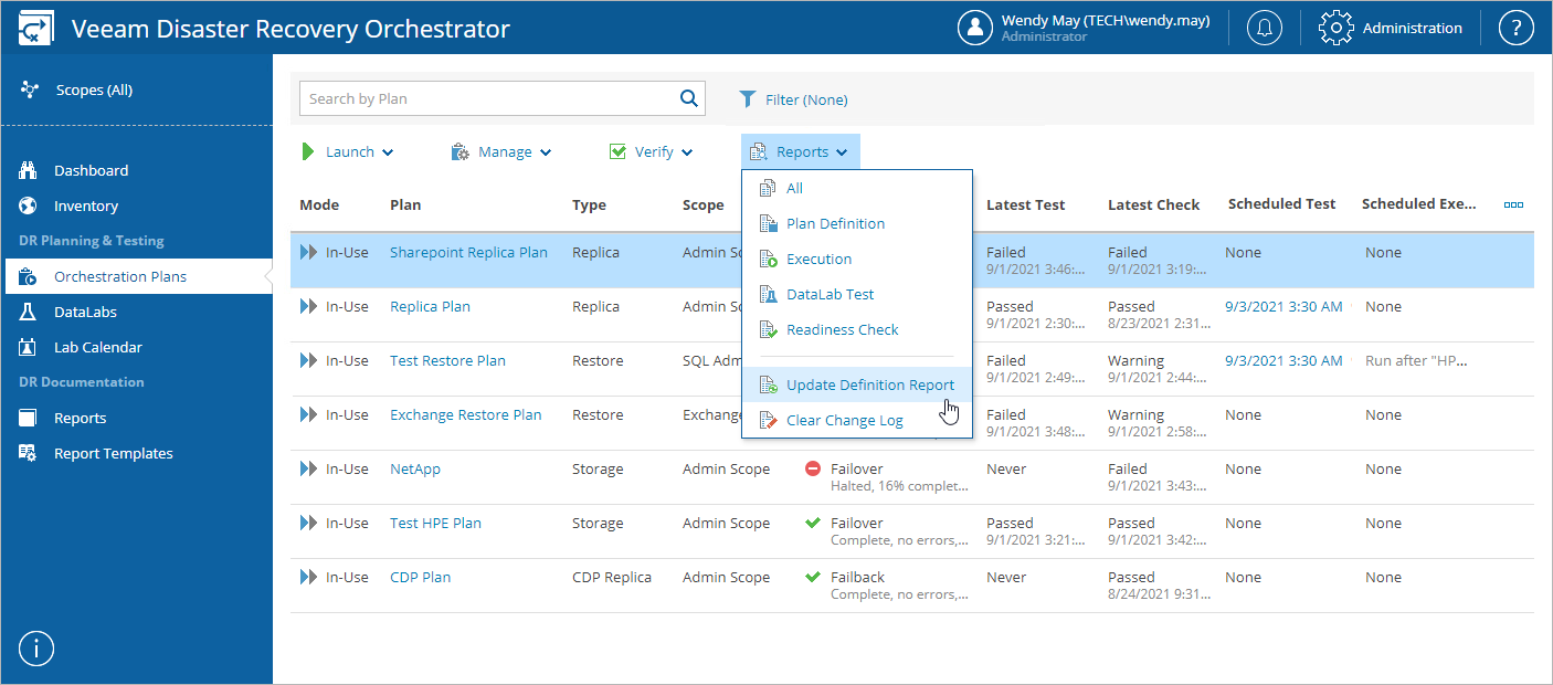

By default, Orchestrator runs the Plan Definition Report automatically for every ENABLED orchestration plan at 7:00 AM daily. You can also generate the report on demand:
- Navigate to Orchestration Plans.
- Select a plan.
- From the Reports menu, select Update Definition Report.
-OR-
Right-click the plan and select Update Definition Report from the drop-down menu.

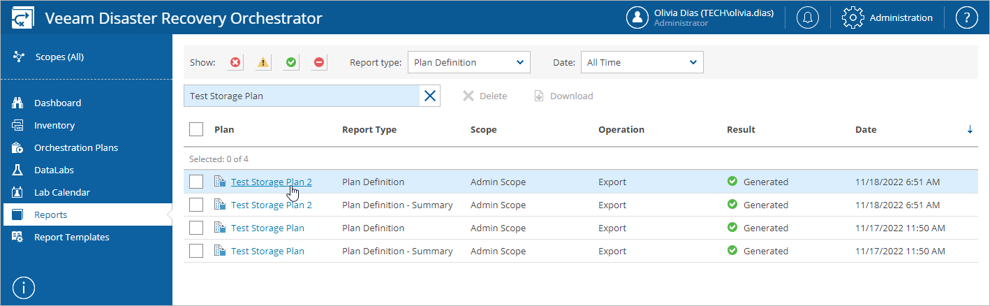

To access the report for an orchestration plan:
- On the Orchestration Plans page, select the plan.
- From the Reports menu, select Plan Definition.
The Reports page will be displayed. The Show Plan Definition reports option will be automatically enabled to display the available Plan Definition Report for the plan.
- Click the plan name to download and open the Plan Definition Report.

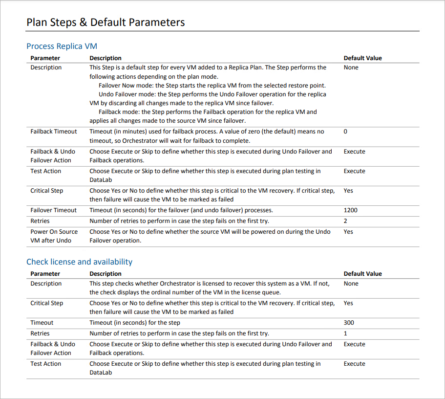

The Plan Definition Report will use the default report template or a custom template. After the template pages, the plan definition will be appended.
By default, Orchestrator generates two types of reports:
- A summary report that includes a plan overview and summary of inventory groups included in the plan with drill-down hyperlinks to individual machines.
- A full report that also includes details on the recovery location specified for the plan, information on specific steps that will run during the recovery process and the plan change log, which allows you to track who changed plan settings, when and what was changed.
