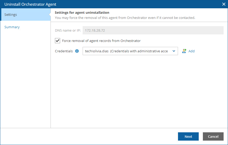

  1. At the Settings step of the wizard, specify the following settings:
  1. Choose whether you want to uninstall the Orchestrator agent regardless of the Veeam Backup & Replication server state.
If Orchestrator is not able to access the server, the Orchestrator agent will be removed from the Orchestrator database but will keep running on the Veeam Backup & Replication server.
  1. From the Credentials drop-down list, select the necessary account for connecting to the server. For an account to be displayed in the Credentials list, it must be added to the configuration database as described in section Adding Credentials. If you have not set up an account beforehand, click Add and follow the steps of the Add Credential wizard. For more information on the required account permissions, see Permissions.
The provided credentials will be also used to launch the Orchestrator agent on the server. The user name must be specified in the DOMAIN\USERNAME format.

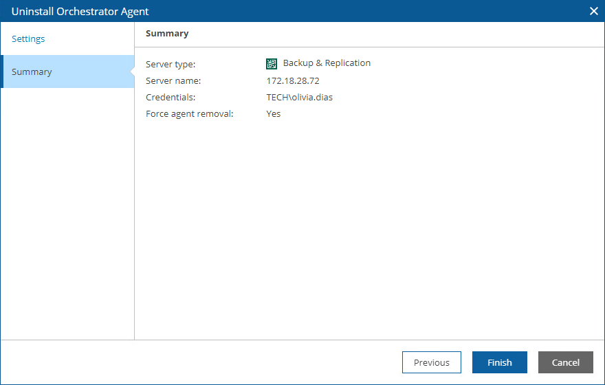

  1. At the Summary step, review the configured settings and click Finish.
Uninstalling VAO Agent
